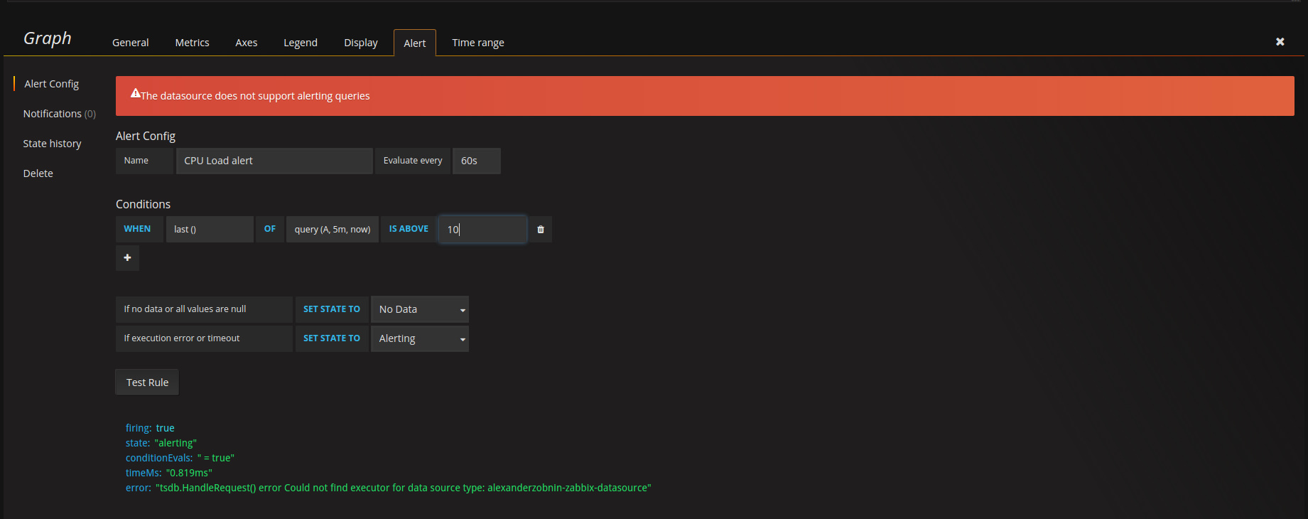

I want to add alert in dashboard using zabbix datasource.And zabbix using mysql to store data.
The question arrise like picture.Somebody has come across this problem?

Grafana alerting does not work with the zabbix datasource. However, have a look at the alerting documentation for grafana zabbix where you see that you can incorporate triggers related to metrics from zabbix and display them in grafana.

Thank you.The problem had resolve.

I had resloved in this way.
Copy alexanderzobnin-zabbix-app to /var/lib/grafana/plugins/ .
