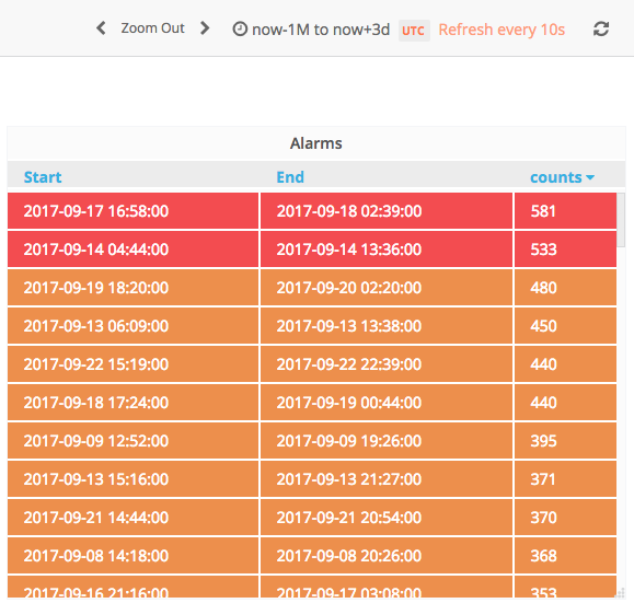

I use Grafana table plugin to load a list of alarms stored on InfluxDB onto my Grafana dashboard as shown above. I want to add another column to this table to show how much time has passed since each alarm. I tried the followings on InfluxDB:

Is it possible only using InfluxQL? Otherwise, should I modify Grafana table plugin to achieve the goal?
