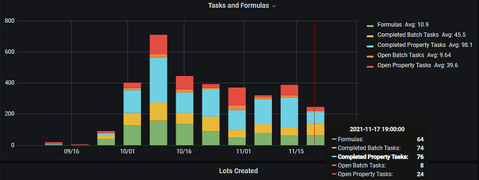

New to Grafana and trying to help out our PM who writes the queries. The short story is that I want my 7 day time interval to show from Mon to Mon, it’s currently showing Wed to Wed (see image below). The query doesn’t have any date offsets or anything like that, it’s just a simple count query and we let Grafana chose the time ranges.

  • What are you trying to achieve? I have a time plot that adds a bunch of distinct events and displays the sum of that count against a time interval
  • What happened? It works fine but when selecting a 7 day interval, I get from Wed to Wed
  • What did you expect to happen? I want it to display Mon - Mon

Welcome to the Grafana forum.
Have you seen this solution?
I think this should fix it, thank you.
Here is another post on the same topic that might be easier to follow.
