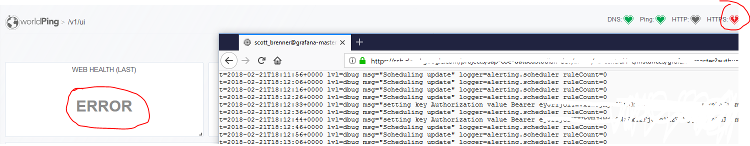

Maybe change the log level to debub, see documentation.
Check the Grafana server log after you would have expected emails to be sent.
Marcus
Did as you suggested, no email alerts were sent when the status changed here and not seeing anything in the logs unfortunately. Any ideas?

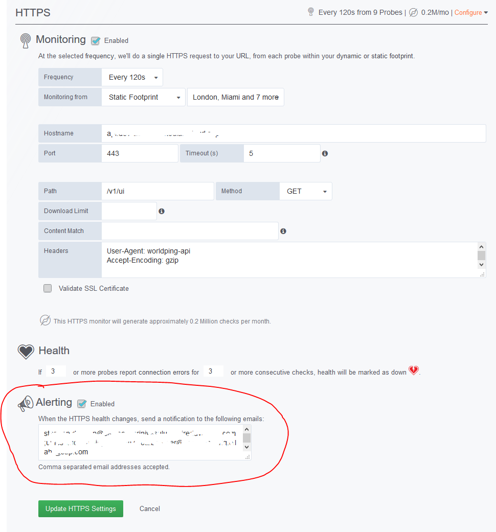

Ah sorry, I’m referring to the alerting in the worldPing config:
I am able to receive test alerts via email from Grafana.
Okay. I tried setting up a https check with alerting to my single email and I received an email saying “https for www.grafana.com is OK”. So could you please try and use a single email just to verify if there are any problems with having a lot of comma-separated email addresses.

Thank you for the suggestions, I changed it to a single email and almost immediately received an email alert! Opened issue #209 for this. I am using the free plan, and am within the 1M monthly check limit.
