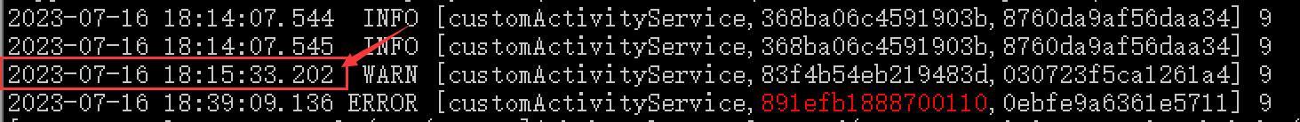

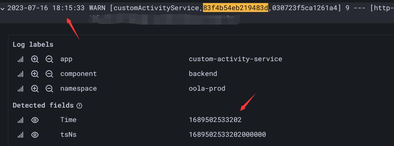

Hello, we have encountered a problem that the time of the collection log and the source log are inconsistent (see the screenshot below).
Our promtail is deployed in the business Pod through sidecarset. When grafana queries the loki log, it is found that the time is about 20 minutes different from the source log. We checked the running logs of promtail and loki, and there was no abnormality. Also checked the pod and loki server time, also correct. So far, we have not found this problem in other logs. Could you please guide us how to find the cause of this issue?

source log:
loki log:
The logs from your second screenshot does not have the trailing 3 digit that the first screen shot does. Is that just from your logs not coming in in the same format? Without that 3 digit your regex won’t fit the log, and the timestamp is therefore not set to the log’s timestamp, rather than the time of collection from promtail.

The first line of our log always has a trailing 3 digits. We queried the next 2 lines of the log. After promtail collected it, we queried the log from loki, and the timestamp was correct.
But found a problem. Since this service is not a request-intensive service, the last log line before 18:39:09.136 is 18:15:33.202, we checked the timestamp of this log, it is the same as the error timestamp of 1689502533202.
The original time of the log: 2023-07-16 18:39:09.136
The wrong one becomes: 2023-07-16 18:15:33.202
(1689503949136 → 1689502533202)
1689502533202 is the timestamp of the last collected log.

2023-07-16T18:42:13.511+0800    {__path__="/tmp/logs/catalina.out"} INFO [customActivityService,471338c0bf32b4e8,89db8d229388c79c] 9 --- [http-nio-8080-exec-7] sdk.biz.info                             : Summary^_^10000^_^null^_^ProtocalMustParams:=&charset=UTF-8&=&method=app.messagetemplate.subscribe.query&timestamp=2023-07-16 18:42:13^_^&format=json^_^ApplicationParams:biz_content={"template_id_list":["","",""],"user_id":""}^_^2ms,22ms,1ms^_^trace_id:21909bb516895041334394597ea618
sample log
2023-07-16 18:15:33.202  WARN [customActivityService,83f4b54eb219483d,030723f5ca1261a4] 9 --- [http-nio-8080-exec-2] o.c.s.i.ActivityPublicServiceServiceImpl : [sadsadsadsadsdsdsadsadsa]sdsads,dsds[dsdsasa21312321]
2023-07-16 18:39:09.136 ERROR [customActivityService,891efb1888700110,0ebfe9a6361e5711] 9 --- [http-nio-8080-exec-9] c.o.ms.handler.GlobalExceptionHandler    :

2023-07-16 18:42:13.511  INFO [customActivityService,471338c0bf32b4e8,89db8d229388c79c] 9 --- [http-nio-8080-exec-7] sdk.biz.info                             : Summary^_^10000^_^null^_^ProtocalMustParams:=&charset=UTF-8&=&method=app.messagetemplate.subscribe.query&timestamp=2023-07-16 18:42:13^_^&format=json^_^ApplicationParams:biz_content={"template_id_list":["","",""],"user_id":""}^_^2ms,22ms,1ms^_^trace_id:21909bb516895041334394597ea618
Your problem is because of this:
- regex:
        expression: '^(?P<time>\d{4}-\d{2}-\d{2} \d{1,2}:\d{2}:\d{2}\.\d{3})\s+?(?P<message>((?P<level>\S+)\s+?\[\S+,(?P<traceid>\S*),(?P<spanid>\S*)\].*))$'
Notice the $ at the end, because of the end of line symbol this will not match your multiline logs. Removing it, however, leads to another issue, because you have:
- output:
        source: message
And because of that your multi-line log won’t actually have any of the stack trace output because the message is being replaced by the regex capture now that it actually matches.
I would recommend removing the output part, and just send everything to Loki, and parse on Loki using LogQL. If it’s not desirable, then you’ll have to figure out a way to distinguish between logs with one line or multiple lines, not to mention the logs will actually have mismatched formation in Loki.

BTW, what is the regex replace part for? Getting rid of empty logs?
Using your method, we removed the $ and output stage. After debugging, it achieved the desired effect. It’s really great, and we fixed a long-standing configuration error. Thank you so much!
Additionally, the regex replace part aims to remove the dates and times from the source log since they have already been extracted into the timestamp and are displayed in a more user-friendly way in Grafana. If we don’t remove the dates and times from the source log, they would be duplicated in Grafana queries. Therefore, we used regex replace. I’m not sure if this approach is correct. Do you have any good suggestions?
I think if that’s the intent then it’s a fine solution. I generally prefer to have the logs be as intact as possible, including the duplicated timestamp. One could argue it’s wasted space, but it does give me the peace of mind knowing that the logs i am looking at is as close to how it was produced as possible. I guess one could say it’s just a personal preference.
