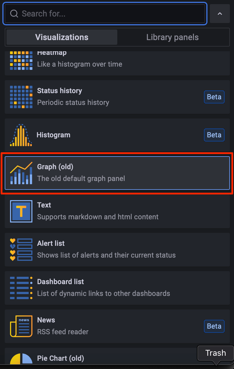

using some sort of graph (e.g.: Graph (old) (type of panel in Grafana)):
