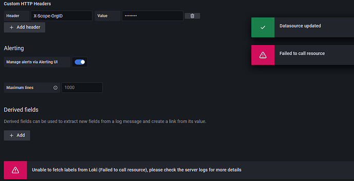

@tonyswumac Thank you for this explanation. I have one more question for clarification. Ex: I have Org A and Org B within Grafana. In Grafana-Agent-Flow several tenant ids are defined and in Loki multi-tenancy enabled. I use the HTTP header field in Org A “X-Scope-OrgID” = “tenant id 1” and that connects but when I switch to Org B and try to set up Loki Datasource with “X-Scope-OrgID” = “tenant id 1” I get back
Unable to fetch labels from Loki (Failed to call resource), please check the server logs for more details
Any idea what’s happening here? Or things to check for? Thanks!
That probably means there is no logs in org B. After enabling multi tenant you should see the chunks going into different directory structure on your chunk storage. You can take a look at /orgb on your chunk storage and see if there is actually any data there.
Thanks for the pointer - it looks like there aren’t Org Ids within S3, just the directories for each tenant id.
As a follow up, how are the Org Id’s defined? I think maybe I’m conflating Grafana Orgs with what we’re talking about for Loki X-Scope Org ID.
Theoretically, what I’m trying to accomplish is defining a Loki data source for each Grafana Org and using the HTTP Header to access a single (or more) tenant id(s).
There isn’t anything that magically link Grafana org and Loki tenant together. So first you should try to get Loki tenant working first (preferably with authentication instead of just HTTP header).
Once you have that, then you can create individual Loki data source in grafana orgs with the tenant ID (or simple authentication) that you desire.

Yep, I’m looking to go super simple like you mentioned at the end.
I have the data source in Grafana Org A working with just the HTTP header pointed at a single tenant.
But when I switch to Org B for set up, it connects to Loki but can’t retrieve that same tenant.
Would I need to add anything to the agent.yaml or the Loki config?
I so appreciate your help with all the newbie questions.
In Org B, what are you using for value for the X-Scope-OrgID header? Make sure that corresponds to an existing tenant in Loki (with data).
Yep! Tenants are the named after the applications the logs are coming from and I can see those in S3. For testing I’m just trying to reuse the tenant that I know is working in OrgA inside the data source of OrgB. Is there any issue with multiple orgs connecting to the same tenant that you’re aware of?
Not that I am aware of. We currently do this, although we use username / password with tenant ID mapping instead of header directly, but even then I don’t see why there would be a reason or that.
Might need to start checking logs then, both on Loki and Grafana sides.
