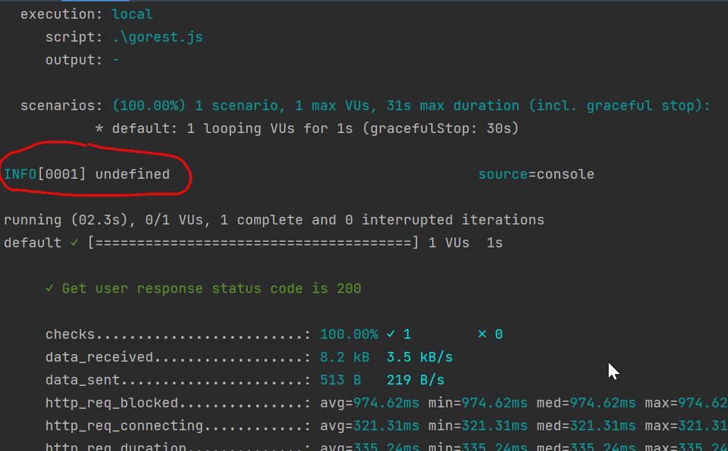

Hi,
I am getting undefined when using
console.log(JSON.stringify(getUserResponse.json()[0]));
but it works fine if I use: console.log(JSON.stringify(getUserResponse.json()));

why it does not work using console.log(JSON.stringify(getUserResponse.json()[0]));
Hi @fatkobra,
From what you’ve given us, it seems, like you have an object and you are getting that objects 0
field. Which just doesn’t exist so you get undefined
I expect that you expected an array and wanted the first element?
Hi @mstoykov ,
yes how do I access the first, second, and so on elements?
Thank you so much for replying.
What you have done would’ve given you the first element of an array, but response is not an array. If you want the first element of the data
field of the response than getUserResponse.json().data
will give you the data so getUserResponse.json().data[0]
should be the first element.

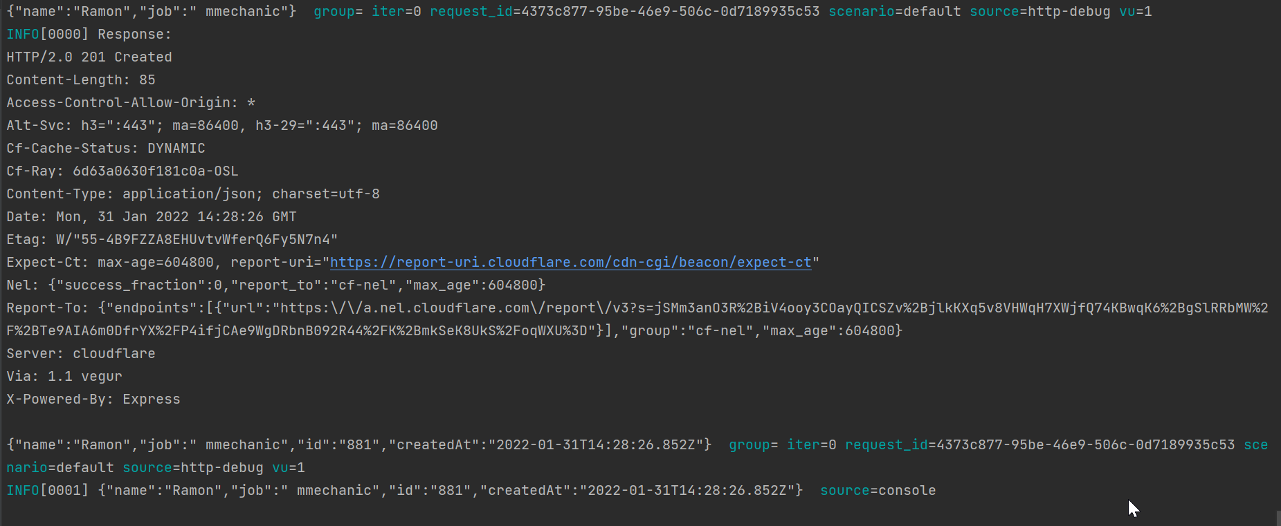

Hey @mstoykov ,
appreciate your patience. I am still a newbie.
Using console.log(JSON.stringify(res.json()));
I do get a response. See attached with --debug
and without.
and without.
Yeah, which seems okay - this is what the API returns. Are you worried about that? Because this likely need to be discussed with whoever is writing the API. The response seems to be a succesful one and if it’s missing something you expect - that might be a bug.
