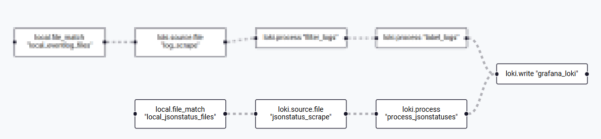

The Alloy Web UI shows the process properly.
