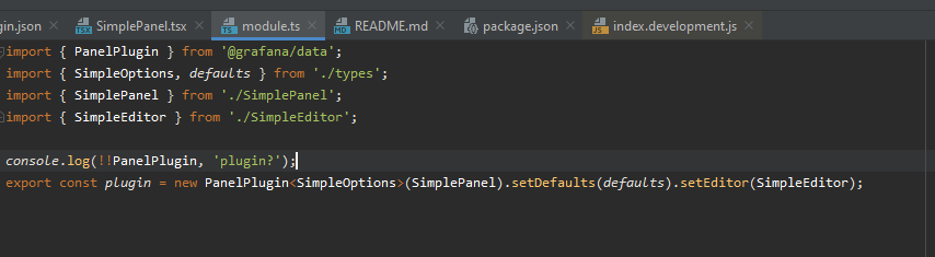

I edited the example plugin to check to see if the Grafana supporting libraries are loaded
This traces out
So that seems to me to say that the plugin is loaded in such a way that it doesn’t have access to the grafana code that was previously loaded. Little help here?
