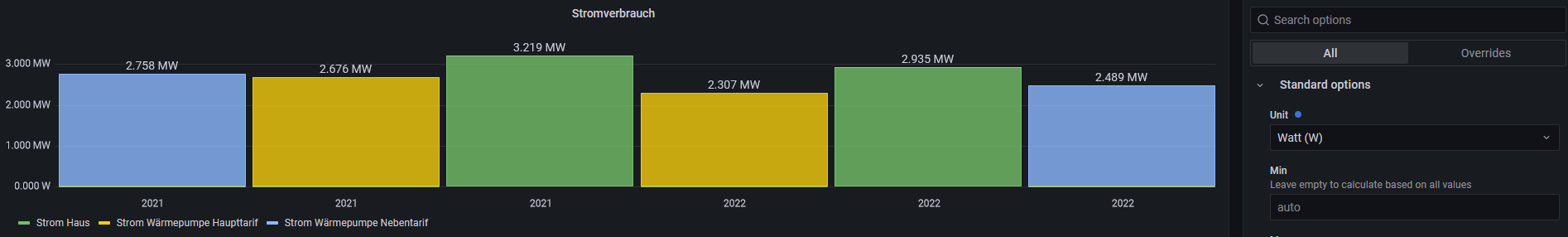

Hello,
Any tips on how to express a home’s electricity consumption in the common unit of thousands of kilowatt-hours?
Thank you and best regards,
Chris

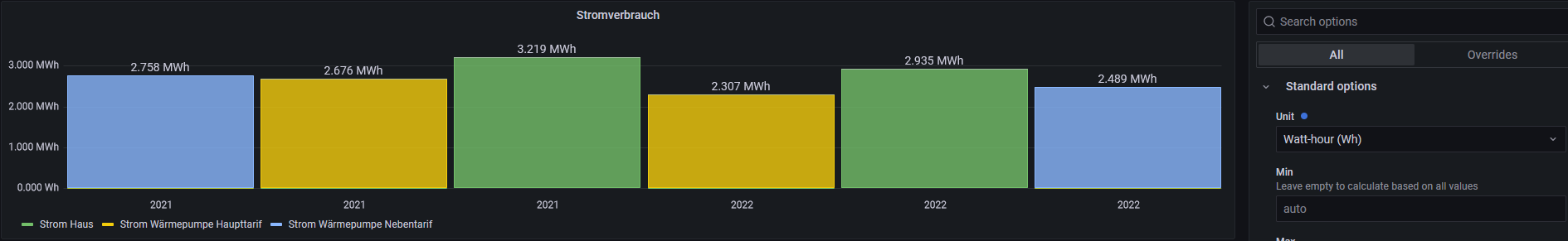

No, it does not help:
I think I have the correct unit “Wh” selected, but Grafana changes the unit by itself from Wh to MWh:
I don’t like “2.489 MWh”, I would like to see “2489 kWh” (the same unit as usual on my power meter and my power bill)

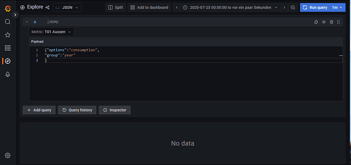

I think that is the actual jaon dashboard.
We need an actual sample json data you are trying to visualize
The electric usage data
Any hint were I can find/access them? Can they be found within Grafana somewhere?
I tried this but I got no answer?!
how is the data stored in in the database? looks like it is mWh. if this is the case please try to set the unit to mWh, then you should get the correct result.
