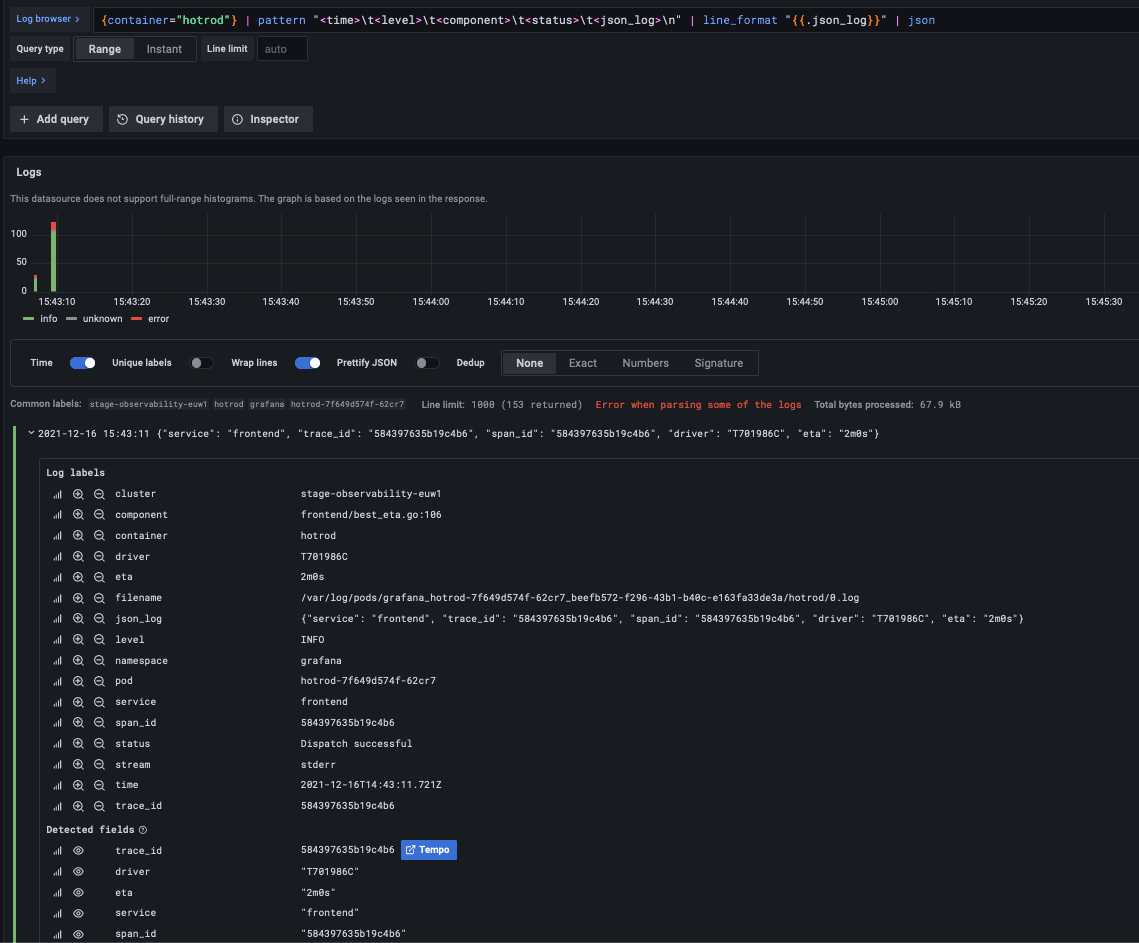

Hi @rupinder10 ,
I the field is not an indexed label, then you will have to apply some parsing first. Even then, the result will basically be a text filter (but you can just click a button instead of typing it in)
Here is an example
Only a few Log labels and a couple of Detected fields
Some parsing applied
Now you can see more Log labels, still the same logs.
Here is the full query as text
{container="hotrod"} | pattern "<time>\t<level>\t<component>\t<status>\t<json_log>\n" | line_format "{{.json_log}}" | json
I can now use the filters, like indexed labels. The query just adds a filter at the end resulting in
{container="hotrod"} | pattern "<time>\t<level>\t<component>\t<status>\t<json_log>\n" | line_format "{{.json_log}}" | json | trace_id="584397635b19c4b6"
Hope that helps. I can elaborate if needed :slight_smile:
