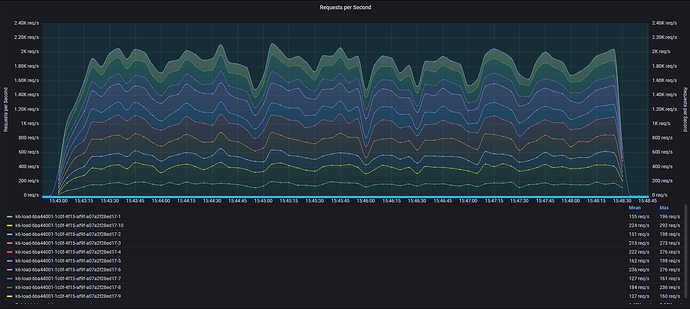

I’ve noticed that the http_reqs metric reported into influxDB seems a bit off.
while I see an average or roughly 1.21k rps
query:
SELECT sum("value") /($__interval_ms / 1000)
FROM "http_reqs"
WHERE $timeFilter
GROUP BY time($__interval), "job_name"
fill(null)
another strange thing with this metric is when taking the mean() function - the result is 1
the metrics I gather from the gateway are as expected by scenario

Hi @nocgod,
I don’t think I fully understand what you expect here. For instance, it seems the first plot shows what you calculated from http_reqs; but in the second plot, how does the query look like exactly? If it’s a builtin function mean in Influx, IMHO, there might be some specifics in how it’s calculated.
the first plot shows http_reqs as reported by a k6 node into influxDB.
the query is:
SELECT sum("value") / ($__interval_ms / 1000)
FROM "http_reqs"
WHERE $timeFilter
fill(null)
I’m normalizing to an average over a second to smoothen the graph

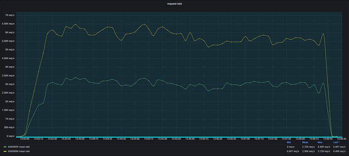

the second plot show the number of requests received in my gateway solution per second
SELECT mean("rate.mean")
FROM "XXXX__requests"
WHERE ("app" = 'XXXX' AND "dc" =~ /^$dc$/ AND "env" =~ /.*$env$/ AND "server" =~ /^$host$/) AND $timeFilter
GROUP BY time($__interval), "server"
fill(linear)
In general, I have 2 instruments on my gateway and the seem to agree about the request rate as seen by the gateway. however, I’ve never been able to see “agreement” between the metrics reported by K6 agents and the gateway metrics.
just to ensure you that my “smoothening” doesn’t affect the general accuracy I’m also attaching 2 images:
SELECT sum("value")
FROM "http_reqs"
WHERE $timeFilter
GROUP BY time(1s), "job_name" fill(null)
and
FROM "http_reqs"
WHERE $timeFilter GROUP BY time($__interval), "job_name"
fill(null)
while the gateway reported roughly 5.5-6K rps in total (2 nodes stacked)
so, what I’m really asking is why the difference between what k6 reports to influx and what the gateway really sees. The gateway is reporting the target rates as defined by the scenario.
