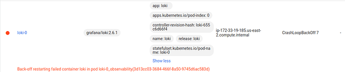

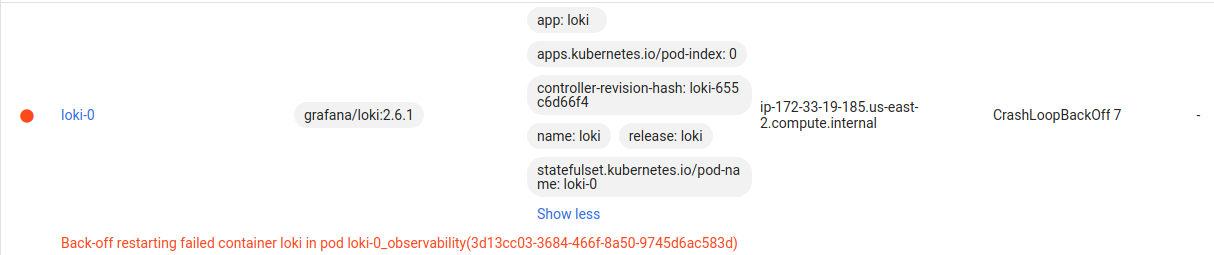

Hello,
I just deployed Loki using helm chart on an eks cluster. Almost all got up and running except the write pods which are failing the **Readiness probe failed: HTTP probe failed with statuscode: 503** . In the logs I can get something like this:
level=error ts=2024-01-11T18:15:56.892357205Z caller=flush.go:143 org_id=fake msg="failed to flush" err="failed to flush chunks: store put chunk: WebIdentityErr: failed to retrieve credentials\ncaused by: SerializationError: failed to unmarshal error message\n\tstatus code: 405, request id: \ncaused by: UnmarshalError: failed to unmarshal error message\n\t00000000  3c 3f 78 6d 6c 20 76 65  72 73 69 6f 6e 3d 22 31  |<?xml version=\"1|\n00000010  2e 30 22 20 65 6e 63 6f  64 69 6e 67 3d 22 55 54  |.0\" encoding=\"UT|\n00000020  46 2d 38 22 3f 3e 0a 3c  45 72 72 6f 72 3e 3c 43  |F-8\"?>.<Error><C|\n00000030  6f 64 65 3e 4d 65 74 68  6f 64 4e 6f 74 41 6c 6c  |ode>MethodNotAll|\n00000040  6f 77 65 64 3c 2f 43 6f  64 65 3e 3c 4d 65 73 73  |owed</Code><Mess|\n00000050  61 67 65 3e 54 68 65 20  73 70 65 63 69 66 69 65  |age>The specifie|\n00000060  64 20 6d 65 74 68 6f 64  20 69 73 20 6e 6f 74 20  |d method is not |\n00000070  61 6c 6c 6f 77 65 64 20  61 67 61 69 6e 73 74 20  |allowed against |\n00000080  74 68 69 73 20 72 65 73  6f 75 72 63 65 2e 3c 2f  |this resource.</|\n00000090  4d 65 73 73 61 67 65 3e  3c 4d 65 74 68 6f 64 3e  |Message><Method>|\n000000a0  50 4f 53 54 3c 2f 4d 65  74 68 6f 64 3e 3c 52 65  |POST</Method><Re|\n000000b0  73 6f 75 72 63 65 54 79  70 65 3e 53 45 52 56 49  |sourceType>SERVI|\n000000c0  43 45 3c 2f 52 65 73 6f  75 72 63 65 54 79 70 65  |CE</ResourceType|\n000000d0  3e 3c 52 65 71 75 65 73  74 49 64 3e 34 58 53 37  |><RequestId>4XS7|\n000000e0  44 35 4e 53 47 32 54 53  58 39 32 51 3c 2f 52 65  |D5NSG2TSX92Q</Re|\n000000f0  71 75 65 73 74 49 64 3e  3c 48 6f 73 74 49 64 3e  |questId><HostId>|\n00000100  59 31 63 32 73 33 34 58  69 41 2f 51 66 75 4a 6a  |Y1c2s34XiA/QfuJj|\n00000110  2f 56 44 4d 77 4c 66 55  44 74 32 6a 4e 62 62 50  |/VDMwLfUDt2jNbbP|\n00000120  4e 5a 65 46 49 56 34 75  32 4c 2b 65 57 42 73 73  |NZeFIV4u2L+eWBss|\n00000130  45 6d 41 6a 42 75 58 32  58 4f 72 35 44 6b 77 62  |EmAjBuX2XOr5Dkwb|\n00000140  38 48 68 7a 45 45 73 43  6e 4b 38 3d 3c 2f 48 6f  |8HhzEEsCnK8=</Ho|\n00000150  73 74 49 64 3e 3c 2f 45  72 72 6f 72 3e           |stId></Error>|\n\ncaused by: unknown error response tag, {{ Error} []}, num_chunks: 2, labels: {app=\"prometheus\", container=\"config-reloader\", filename=\"/var/log/pods/monitoring_prometheus-prometheus-kube-prometheus-prometheus-0_d8acbc12-277d-497b-927c-982bd9360613/config-reloader/0.log\", instance=\"prometheus-kube-prometheus-prometheus\", job=\"monitoring/prometheus\", namespace=\"monitoring\", node_name=\"ip-172-21-15-42.ec2.internal\", pod=\"prometheus-prometheus-kube-prometheus-prometheus-0\", stream=\"stdout\"}"
level=info ts=2024-01-11T18:15:56.892437306Z caller=flush.go:167 msg="flushing stream" user=fake fp=12133b108c9b4096 immediate=true num_chunks=1 labels="{app=\"timescaledb\", container=\"timescaledb-full\", filename=\"/var/log/pods/test_timescaledb-full-weekly-28261344-5w67h_c4fbc583-e893-4ac7-8626-b877649cc4f7/timescaledb-full/2.log\", job=\"test/timescaledb\", namespace=\"test\", node_name=\"ip-172-21-15-42.ec2.internal\", pod=\"timescaledb-full-weekly-28261344-5w67h\", stream=\"stderr\"}"
level=info ts=2024-01-11T18:15:56.892514196Z caller=flush.go:167 msg="flushing stream" user=fake fp=b4fd60a8141d0278 immediate=true num_chunks=1 labels="{app=\"timescaledb\", container=\"timescaledb-full\", filename=\"/var/log/pods/test_timescaledb-full-weekly-28260945-rkdhn_ff7b2ee6-350f-4d43-a8fb-4e75a46e5f85/timescaledb-full/2.log\", job=\"test/timescaledb\", namespace=\"test\", node_name=\"ip-172-21-15-42.ec2.internal\", pod=\"timescaledb-full-weekly-28260945-rkdhn\", stream=\"stderr\"}"
but nothing about the readiness probes.
When I run a curl to the /ready I get the following output:
Some services are not Running:
Running: 8
Starting: 1
Any suggestion on how can I fix it?
Sounds like your storage configuration may be incorrect. Can you share your configuration please?
figured it out. Also had to modify the IAM role. Thank you for your reply.
The question how would I differentiate the logs from which eks is comming from?
Can you tell me how you resolved this? Same error here.
I was using IAM role to give access to the s3 bucket and we had to give more access to the role. So the fix has to do with proper access to the s3 bucket.

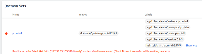

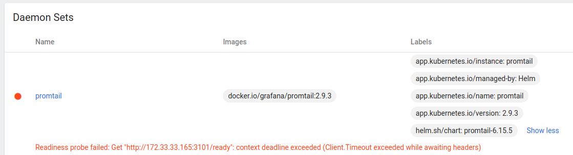

Get error
level=warn ts=2024-02-14T12:56:01.29122951Z caller=client.go:419 component=client host=loki-gateway msg="error sending batch, will retry" status=502 tenant= error="server returned HTTP status 502 Bad Gateway (502): <html>"
level=warn ts=2024-02-14T12:56:15.880214534Z caller=client.go:419 component=client host=loki-gateway msg="error sending batch, will retry" status=-1 tenant= error="Post \"http://loki-gateway/loki/api/v1/push\": context deadline exceeded"
level=warn ts=2024-02-14T12:56:38.801582325Z caller=client.go:419 component=client host=loki-gateway msg="error sending batch, will retry" status=-1 tenant= error="Post \"http://loki-gateway/loki/api/v1/push\": context deadline exceeded"
level=warn ts=2024-02-14T12:56:55.298525149Z caller=client.go:419 component=client host=loki-gateway msg="error sending batch, will retry" status=502 tenant= error="server returned HTTP status 502 Bad Gateway (502): <html>"
level=warn ts=2024-02-14T12:57:46.536263223Z caller=client.go:419 component=client host=loki-gateway msg="error sending batch, will retry" status=-1 tenant= error="Post \"http://loki-gateway/loki/api/v1/push\": context deadline exceeded"
level=warn ts=2024-02-14T12:59:00.239110929Z caller=client.go:419 component=client host=loki-gateway msg="error sending batch, will retry" status=502 tenant= error="server returned HTTP status 502 Bad Gateway (502): <html>"
level=warn ts=2024-02-14T13:02:44.367017881Z caller=client.go:419 component=client host=loki-gateway msg="error sending batch, will retry" status=502 tenant= error="server returned HTTP status 502 Bad Gateway (502): <html>"
level=error ts=2024-02-14T13:02:44.367060669Z caller=client.go:430 component=client host=loki-gateway msg="final error sending batch" status=502 tenant= error="server returned HTTP status 502 Bad Gateway (502): <html>"
level=warn ts=2024-02-14T13:02:45.386267559Z caller=client.go:419 component=client host=loki-gateway msg="error sending batch, will retry" status=502 tenant= error="server returned HTTP status 502 Bad Gateway (502): <html>"
level=warn ts=2024-02-14T13:02:46.266937527Z caller=client.go:419 component=client host=loki-gateway msg="error sending batch, will retry" status=502 tenant= error="server returned HTTP status 502 Bad Gateway (502): <html>"
level=warn ts=2024-02-14T13:02:57.622440626Z caller=client.go:419 component=client host=loki-gateway msg="error sending batch, will retry" status=-1 tenant= error="Post \"http://loki-gateway/loki/api/v1/push\": context deadline exceeded"
level=warn ts=2024-02-14T13:03:00.268672021Z caller=client.go:419 component=client host=loki-gateway msg="error sending batch, will retry" status=502 tenant= error="server returned HTTP status 502 Bad Gateway (502): <html>"
level=warn ts=2024-02-14T13:03:15.923348769Z caller=client.go:419 component=client host=loki-gateway msg="error sending batch, will retry" status=-1 tenant= error="Post \"http://loki-gateway/loki/api/v1/push\": context deadline exceeded"
level=warn ts=2024-02-14T13:03:35.544348244Z caller=client.go:419 component=client host=loki-gateway msg="error sending batch, will retry" status=-1 tenant= error="Post \"http://loki-gateway/loki/api/v1/push\": context deadline exceeded"
level=warn ts=2024-02-14T13:03:58.511198812Z caller=client.go:419 component=client host=loki-gateway msg="error sending batch, will retry" status=502 tenant= error="server returned HTTP status 502 Bad Gateway (502): <html>"
level=warn ts=2024-02-14T13:04:44.29905186Z caller=client.go:419 component=client host=loki-gateway msg="error sending batch, will retry" status=502 tenant= error="server returned HTTP status 502 Bad Gateway (502): <html>"
level=warn ts=2024-02-14T13:06:46.912740573Z caller=client.go:419 component=client host=loki-gateway msg="error sending batch, will retry" status=-1 tenant= error="Post \"http://loki-gateway/loki/api/v1/push\": context deadline exceeded"
level=warn ts=2024-02-14T13:09:35.535411128Z caller=client.go:419 component=client host=loki-gateway msg="error sending batch, will retry" status=502 tenant= error="server returned HTTP status 502 Bad Gateway (502): <html>"
level=error ts=2024-02-14T13:09:35.535469886Z caller=client.go:430 component=client host=loki-gateway msg="final error sending batch" status=502 tenant= error="server returned HTTP status 502 Bad Gateway (502): <html>"
level=warn ts=2024-02-14T13:09:43.819323719Z caller=client.go:419 component=client host=loki-gateway msg="error sending batch, will retry" status=502 tenant= error="server returned HTTP status 502 Bad Gateway (502): <html>"
level=warn ts=2024-02-14T13:09:44.704950618Z caller=client.go:419 component=client host=loki-gateway msg="error sending batch, will retry" status=502 tenant= error="server returned HTTP status 502 Bad Gateway (502): <html>"
level=warn ts=2024-02-14T13:09:53.291821659Z caller=client.go:419 component=client host=loki-gateway msg="error sending batch, will retry" status=502 tenant= error="server returned HTTP status 502 Bad Gateway (502): <html>"
level=warn ts=2024-02-14T13:09:56.020764517Z caller=client.go:419 component=client host=loki-gateway msg="error sending batch, will retry" status=502 tenant= error="server returned HTTP status 502 Bad Gateway (502): <html>"
level=warn ts=2024-02-14T13:10:03.562996534Z caller=client.go:419 component=client host=loki-gateway msg="error sending batch, will retry" status=502 tenant= error="server returned HTTP status 502 Bad Gateway (502): <html>"
level=warn ts=2024-02-14T13:10:22.016775966Z caller=client.go:419 component=client host=loki-gateway msg="error sending batch, will retry" status=-1 tenant= error="Post \"http://loki-gateway/loki/api/v1/push\": context deadline exceeded"
level=warn ts=2024-02-14T13:10:52.175425586Z caller=client.go:419 component=client host=loki-gateway msg="error sending batch, will retry" status=-1 tenant= error="Post \"http://loki-gateway/loki/api/v1/push\": context deadline exceeded"
level=warn ts=2024-02-14T13:11:39.444773648Z caller=client.go:419 component=client host=loki-gateway msg="error sending batch, will retry" status=502 tenant= error="server returned HTTP status 502 Bad Gateway (502): <html>"
level=warn ts=2024-02-14T13:13:25.967490592Z caller=client.go:419 component=client host=loki-gateway msg="error sending batch, will retry" status=-1 tenant= error="Post \"http://loki-gateway/loki/api/v1/push\": context deadline exceeded"
level=warn ts=2024-02-14T13:17:09.523304782Z caller=client.go:419 component=client host=loki-gateway msg="error sending batch, will retry" status=502 tenant= error="server returned HTTP status 502 Bad Gateway (502): <html>"
level=error ts=2024-02-14T13:17:09.523340021Z caller=client.go:430 component=client host=loki-gateway msg="final error sending batch" status=502 tenant= error="server returned HTTP status 502 Bad Gateway (502): <html>"
level=warn ts=2024-02-14T13:17:20.584789183Z caller=client.go:419 component=client host=loki-gateway msg="error sending batch, will retry" status=-1 tenant= error="Post \"http://loki-gateway/loki/api/v1/push\": context deadline exceeded"
level=warn ts=2024-02-14T13:17:31.174531171Z caller=client.go:419 component=client host=loki-gateway msg="error sending batch, will retry" status=-1 tenant= error="Post \"http://loki-gateway/loki/api/v1/push\": context deadline exceeded"
level=warn ts=2024-02-14T13:17:39.467062575Z caller=client.go:419 component=client host=loki-gateway msg="error sending batch, will retry" status=502 tenant= error="server returned HTTP status 502 Bad Gateway (502): <html>"
level=warn ts=2024-02-14T13:17:49.451097041Z caller=client.go:419 component=client host=loki-gateway msg="error sending batch, will retry" status=502 tenant= error="server returned HTTP status 502 Bad Gateway (502): <html>"
level=warn ts=2024-02-14T13:17:55.492331987Z caller=client.go:419 component=client host=loki-gateway msg="error sending batch, will retry" status=502 tenant= error="server returned HTTP status 502 Bad Gateway (502): <html>"
level=warn ts=2024-02-14T13:18:20.938906029Z caller=client.go:419 component=client host=loki-gateway msg="error sending batch, will retry" status=-1 tenant= error="Post \"http://loki-gateway/loki/api/v1/push\": context deadline exceeded"
level=warn ts=2024-02-14T13:18:57.620944747Z caller=client.go:419 component=client host=loki-gateway msg="error sending batch, will retry" status=-1 tenant= error="Post \"http://loki-gateway/loki/api/v1/push\": context deadline exceeded"
level=warn ts=2024-02-14T13:20:04.956056356Z caller=client.go:419 component=client host=loki-gateway msg="error sending batch, will retry" status=-1 tenant= error="Post \"http://loki-gateway/loki/api/v1/push\": context deadline exceeded"
level=warn ts=2024-02-14T13:21:46.371829832Z caller=client.go:419 component=client host=loki-gateway msg="error sending batch, will retry" status=-1 tenant= error="Post \"http://loki-gateway/loki/api/v1/push\": context deadline exceeded"
level=warn ts=2024-02-14T13:24:45.625712299Z caller=client.go:419 component=client host=loki-gateway msg="error sending batch, will retry" status=502 tenant= error="server returned HTTP status 502 Bad Gateway (502): <html>"

can you please add the output of kubectl get pods -n observability?
Mostly interested in the loki pod states.
This does not seam to be the same issue as I was having the pods constnatly restarting and never getting into ready state.
The promtail doesn’t seem to want to be executed
I redid the Loki installation now with the stack - helm install grafana/loki-stack, but I still have errors
