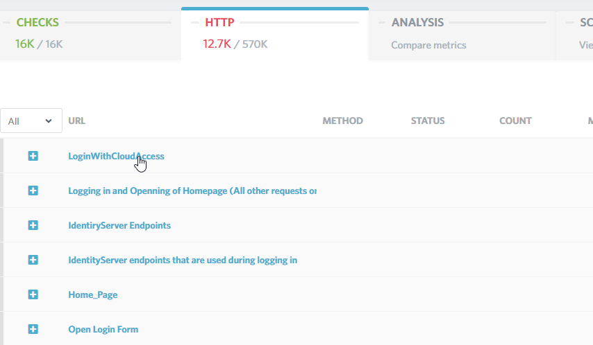

P.S don’t understand why this error appeared and interrupted the test session even though we have only several groups (total 5) wherein only 1 group contains endpoints where set a parametrization for some arguments in URL

As for the aborted by limit, that’s due to the unique URLs. Each unique URL is going to produce 7 individual metrics. It will also make the HTTP tab a bit hard to parse / derive trends from. Test 657220 has a bunch of requests with a count of 2. You should use tags, specifically the name tag to group those similar URLs together. This will make the min/max/percentile metrics much more meaningful for those “same” endpoints requested.

  2. aborted by limit - I thought that being enclosed in the group() makes it grouping into the unique one. Ok, I fixed it as well, it seems works nice now.
