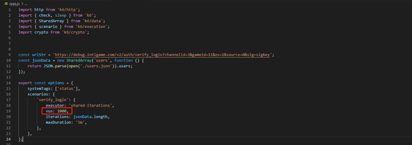

I tried load a JSON file in the script, K6 can execute script and generated aggregate report, but why the progress bar displayed failure?

Given what you are currently seeing I would argue you need more than 100 VUs - at least 400, probably more.
I set VU to 400ďźbut 400 VU and 100 VU seem to have the same effect on progress bar movement, ===> moving very slowly
, the result was same
No it isnât - the http_re_duration went from median of 32.54ms at 100VUs to 132.96ms at 400VUs and to 330.69ms at 1000VUS.
Given that you donât seem to be bandwitdh limitted (doing under 2MB/s) I would expect that either the local machine you are running from doesnât have enough resources or the limit of your system under test is arund 2660 QPS.
There are definitely other explanations but those are the simplest.
So I would now go look at both systems and see how they behave while the load is happening. Are they running out of CPU? Is a DB that is used not returning fast enough? Is it just that the system doing the test running out of CPU and canât do more?
