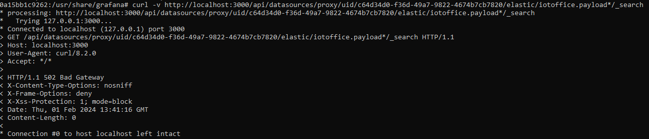

Here is the result with my development elastic endpoint :
(This is the same result for the qualification elastic endpoint)
With thejsonplaceholder (-k for SSL) :
curl_external_api
So it works.
Whith the proxy URL :
+verbose :
PS : I noticed with a -verbose in my elastic URL that it uses the HTTPS_PROXY env variable which is my company proxy. Is it a problem ?
The curl to the grafana proxy won’t really work because you need cookies and some headers for it to work, but the fact that the jsonplaceholder api returns data and your internal elastic returns 502 means that the problem is in your elastic endpoint and not the grafana proxy.
Once you manage to make curl work with your elastic endpoint you can be sure it is not a problem of the container accessing the resources.
Grafana should pick up the HTTPS_PROXY without problem and use it if it is defined.
@academo I used --noproxy and it worked better !
