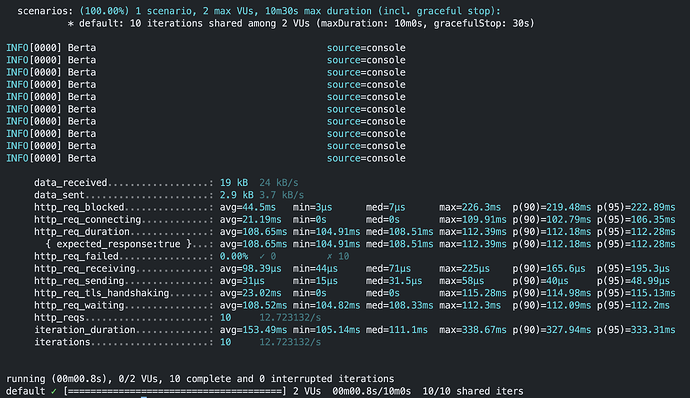

I did some testing with the script below:
import http from 'k6/http';
let body = JSON.parse(open('./croc.json'));
export let options = {
    vus: 2,
    iterations: 10,
export default function (data) {
    // VU code
    let res = http.post('https://httpbin.test.k6.io/anything', body);
    console.log(res.json().form.name);
and the croc.json file:
    "name": "Berta",
    "sex": "F",
    "date_of_birth": "2019-01-01"
Which outputs:
