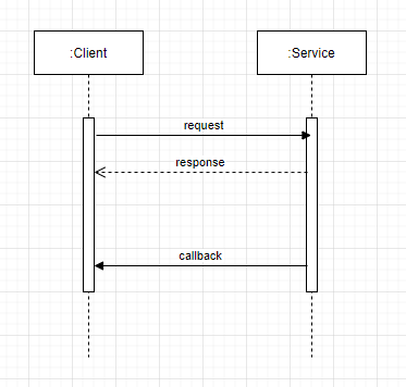

we are considering using K6 to load test one of our backend applications. The truth is that K6 looks very good and we like a lot what we are reading. We just have a question about how to test one of our scenarios.
Some of the tasks that our application does take a lot of time (between 5-10 minutes). The client sends a request, an identifier is returned, the task starts processing and when the task is finished the service does a callback to send the result.
Can K6 test the time between sending the request and receiving the response?
Thank you very much
Hi there, welcome to the forum :slight_smile:
I’m confused with your usage of “callback” here. According to your diagram, the service makes a call back to the client. Are you using a bidirectional protocol like WebSockets? k6 doesn’t have good support yet for mechanisms like HTTP long polling or Server Sent Events, which you would typically use to implement callbacks.
So I’m assuming your client is making HTTP requests to the status endpoint at a specific interval using the task identifier to check the progress, correct? This isn’t really a callback, though, just regular polling. :slight_smile:
If so, you can keep track of the time it takes between when the client makes the initial request, and when it receives the response that the task is finished, using Date.now(), and then add the result to a custom metric. You can see a similar solution here.
Hope this helps!

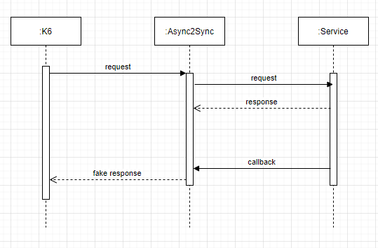

Another option that has occurred to us is to place a third application between K6 and the application that makes the asynchronous calls synchronous.
That might work as well, but yeah, will require development of that helper service.
