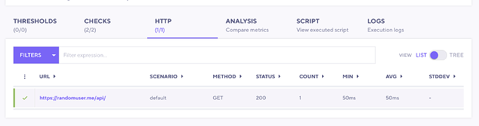

Hi @jiideeh
Can you share the k6 version you are running this with? I tested with my cloud account a similar script (1 VU, 1 iteration), with k6 version 0.43 and did not get the same error.
