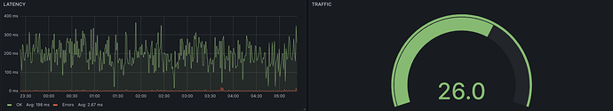

Hi again @dominiclovell and sorry for the delay.
Just to be clear, what you are envisioning is that one would select a variable from a list at the top (Host, Database and Listener) and then have “only the panels/visualizations” related to that variable. So for Host, it might be:

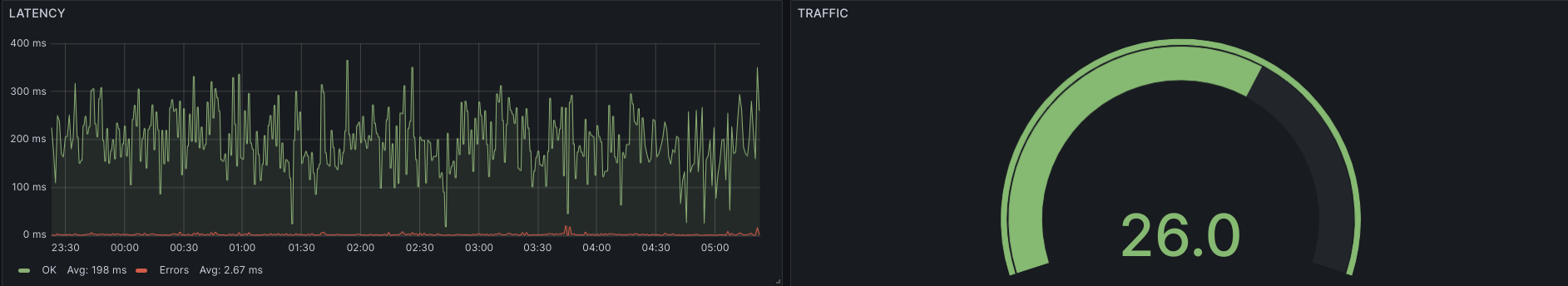

and for Listener, it might be:
