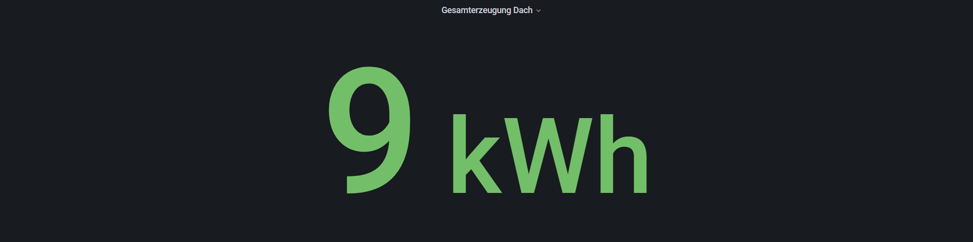

Which results in this stat panel:
The left value is the correct one which I want to keep.
I only managed to keep the right value which is not what I want to, by addig

Hi Grant,
thanks for your reply. Unfortunately replacing keep with drop does lead to the same result as visible in the second picture.
This is the output of the data explorer (note that the values are different from the values in Grafana as the time range in Grafana was set to October and in the data explorer to the last 30 days)
Sorry for posting a picture but the csv export looks even more strange.
The very last value seems to be the correct sum.
Many thanks for your assistance!

HI @percy2live
OK, going back to the query where you got the two results (but want only the left one), try doing a transformation like this:
BEFORE:
AFTER:
Thanks Grant, that did the trick.
