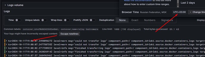

Browser Time shows UTC+03:00
And in the grafana panel ts=2024-10-11T19:18:07.269384087Z although the current time is 22:18:07

@tonyswumac do you know why it is in utc? Because if this was visualized in time series it would be in local time but in the list it is still raw utc
I suspect the ts shown in the screenshot is probably not the actual timestamp of the logs, but rather part of the log. I would recommend to make sure logs are properly parsed for timestamp.
