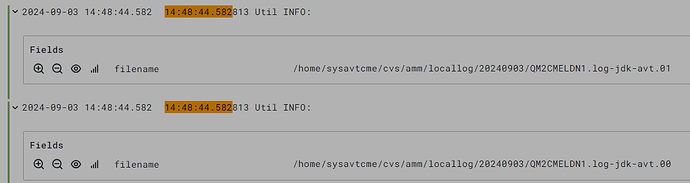

However I am observing duplicated log lines in loki with different filenames:

When you rename and create a file, promtail will read through the entire file again because the file name is now different, and promtail doesn’t have a record of the file being read.
I think the easiest solution is to just watch for the first file (assuming the file name for the first file stays the same).
