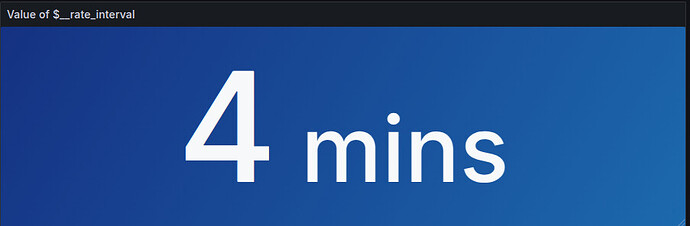

$__rate_interval is only templated in prometheus data source, you can’t get it outside of the query. For a workaround, you could try making a panel with vector($__rate_interval) query and displaying it at the top of the dashboard. Notice though that if you’re using time overrides, the $__rate_interval value might (and most probably will) differ.
If the provided query doesn’t work (I’m not using prometheus directly), you can try setting the value of $__rate_interval as a label: label_replace(time(), "interval", "$__rate_interval", "", "")
