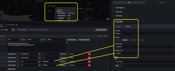

Here is the result of your sample data.

time average_response_ms host maximum_response_ms minimum_response_ms name packets_received packets_transmitted percent_packet_loss resul t_code standard_deviation_ms ttl url
So you have no hostname, ipaddress coming from the ping. You also do not have longitude,latitude coming for those devices. And there is no way to marry these two data points.
Conclusion: This is not going to work for you.
