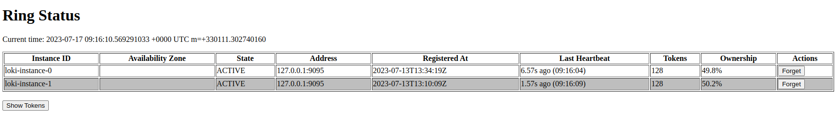

I am deploying a loki in HA with currently two nodes (without Kubernetes).
Overall it works fine.
However, when I make requests to find logs, the number of logs returned differs half the time.
For example, query 1 on a fixed range hits instance 1 and returns me 430 records.
I relaunch the same query which hits instance 2 and returns 230 records this time.
Being in the migration phase, I have another loki (non HA) somewhere else that receives the same traffic as my new HA loki.
When I make this same request, I receive 660 records, the sum of the two previous requests (230 + 430) on the loki HA!
Do you have any idea what could be happening?
For information:
  • I use a s3 bucket to store indexes
  • Each loki instance is running in target=all
  • Each Loki instance is contacted through an nginx reverse proxy
  • I have upstream of each reverse proxy, a load balancer provided by my cloud provider which returns in round robin to my nginx servers
Thx for your help !!

Sounds like the two instances don’t see each other as part of the ring membership. What do you see from /ring?
Hi and thx for your help.
Yes my ring seem be ok:
All services are running:
Couple of things to potentially try:
  1. I notice you have max_chunk_age: 2h0m0s, if you try to query logs older than 2 hours (or 3 hours), do you notice the same split behavior?

With the following config:
auth_enabled: false
limits_config:
  enforce_metric_name: false
  reject_old_samples: true
  reject_old_samples_max_age: 168h
  retention_period: 744h
  split_queries_by_interval: 0s
  max_cache_freshness_per_query: 10m
  max_query_parallelism: 32
http_prefix:
server:
  http_listen_port: 3100
  log_level: debug
compactor:
  working_directory: /loki/compactor
  retention_enabled: true
  retention_delete_delay: 2h
  shared_store: s3
  compaction_interval: 5m
  compactor_ring:
    kvstore:
        store: memberlist
common:
  ring:
    instance_addr: 127.0.0.1
    kvstore:
      store: memberlist
  replication_factor: 1
  path_prefix: /loki
memberlist:
  node_name: loki-instance-1
  join_members:
        - "loki-instance-0.priv"
        - "loki-instance-1.priv"
schema_config:
  configs:
  - from: 2020-09-07
    store: boltdb-shipper
    object_store: s3
    schema: v11
    index:
      prefix: loki_index_
      period: 24h
storage_config:
  boltdb_shipper:
    shared_store: s3
    active_index_directory: /loki/index
    cache_location: /loki/boltdb-cache
    cache_ttl: 24h         # Can be increased for faster performance over longer query periods, uses more disk space
  aws:
    s3: "s3://[...]:[...]@s3.fr-par.scw.cloud/[...]"
    region: fr-par
    s3forcepathstyle: true
chunk_store_config:
  max_look_back_period: 744h
table_manager:
  retention_deletes_enabled: true
querier:
  query_ingesters_within: 2h
query_scheduler:
  max_outstanding_requests_per_tenant: 4096
  scheduler_ring:
    kvstore:
      store: memberlist
frontend:
  log_queries_longer_than: 5s
  max_outstanding_per_tenant: 4096
  compress_responses: true
query_range:
  align_queries_with_step: true
  max_retries: 5
  parallelise_shardable_queries: false
  cache_results: true
  results_cache:
    cache:
      embedded_cache:
        enabled: true
        ttl: 24h
distributor:
  ring:
    kvstore:
      store: memberlist
ingester:
  max_chunk_age: 2h
  lifecycler:
    ring:
      kvstore:
        store: memberlist
  chunk_idle_period: 30m
  chunk_block_size: 262144
  chunk_encoding: snappy
  chunk_retain_period: 1m
  max_transfer_retries: 0
  wal:
    dir: /loki/wal
index_gateway:
  ring:
    kvstore:
      store: memberlist
Couple of things to try:
  1. Remove the instance_addr configuration:
common:
  ring:
    # instance_addr: 127.0.0.1
    kvstore:
      store: memberlist
  path_prefix: /loki
  1. Remove the node_name from memberlist:
memberlist:
  # node_name: loki-instance-1
  join_members:
See if that helps.
