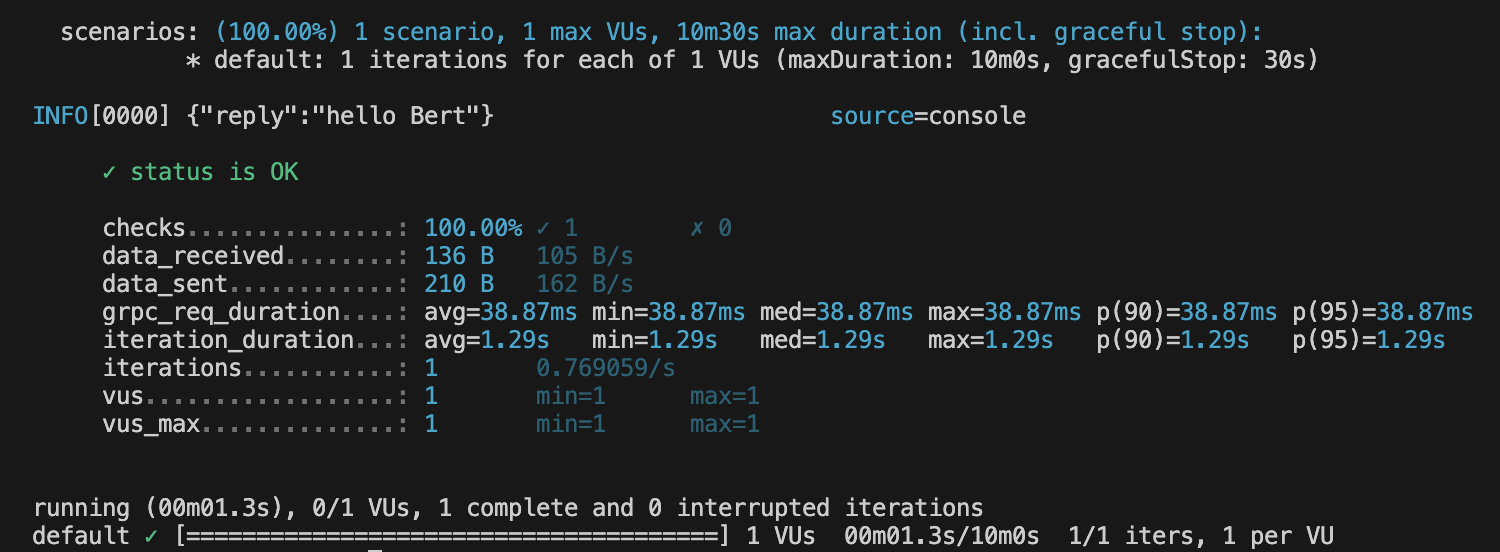

And the results look good:
I would start by testing the same example, which should work.
