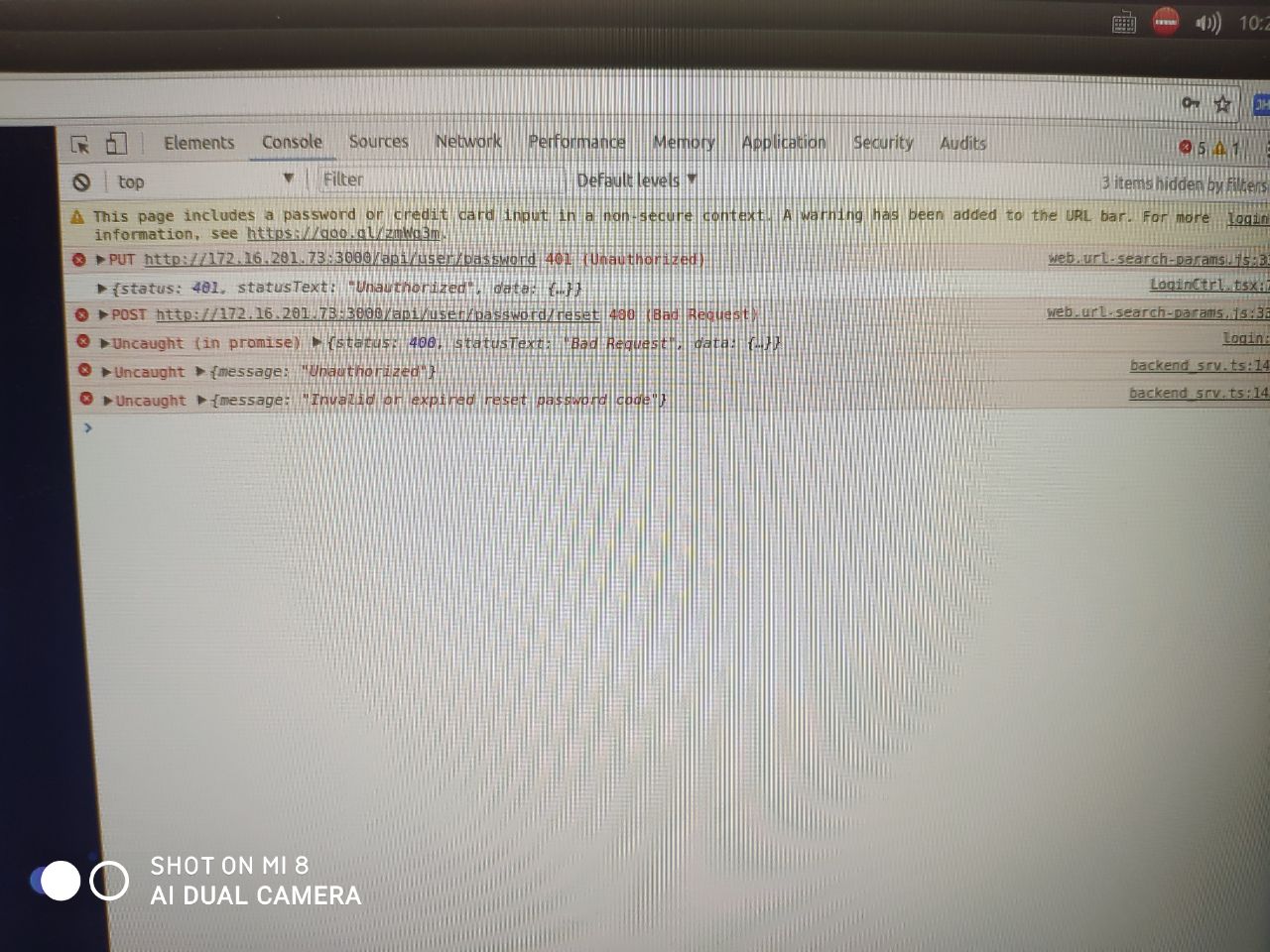

i got the same problem.grafana 7.1.3 using Standalone Linux Binaries.

i can log in using admin, but can’t modify password, and can’t go to home page if i click skip modify password
