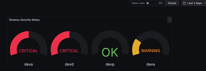

What I have with “5 mins”
What I have with “2 days”
I only want “deva” to show “Warning” as that’s what it was 2 days ago. I don’t want it to show historic and current.
