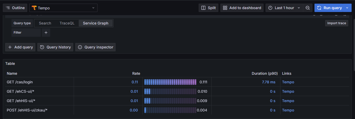

Hello, I have the following problem when collecting data with OTEL from my application that runs on Tomcat.
I see the following error in the catalina.out logs
[otel.javaagent 2024-04-28 19:57:59:494 -0300] [OkHttp http://10.250.2.89:4318/...] WARN io.opentelemetry.exporter.internal.http.HttpExporter - Failed to export metrics. Server responded with HTTP status code 404. Error message: Unable to parse response body, HTTP status message: Not Found
The strange thing is that I see data in “grafana” but not much else
Additionally I see that the container “tempo_k6-tracing_1” fails
