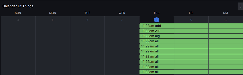

Moreover, I visited Volkov Labs and I wanted to know which if this is Grafana panels which is being used ? if yes, which panel it is? I have same kind of requirement.
See attached image please.
Instead of inage please post the link to this panel cause volkov has tons of them
Link in my message would have redirected you to the same panel I am referring to.
https://release.volkovlabs.io/d/p2QspFaVk/release?orgId=1&refresh=5m&viewPanel=2

This looks to be the calendar grafana plugin see details here
@yosiasz Bingo!
@parpitku Here is the latest video about the Calendar panel

@parpitku Try the calendar panel.
  1. Unix-based timestamp and ISO supported out of the box.
  2. Event Type can be selected as a label and displayed using cards in the side Drawer when looking at the particular event of the whole day.
The JSON content can be parsed into separate fields and displayed as titles, descriptions, colors, etc.
We have a new version coming later this week.
