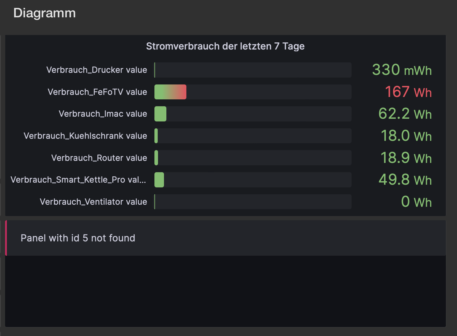

If I understand correctly, then I seem to have the same problem. I have created a panel that shows me the power consumption of the last 7 days. Then I duplicated the panel and set the time range to -1d on the duplicated panel. Both panels are shown to me in Grafana. The panel with the 7 days has the ID 4, the panel with the setting -1d has the ID 5
If I now insert the two panels into my dashboard via the embed link, only the one with the 7 days is displayed. The other one says: Not found - Look here:
How can I fix this?

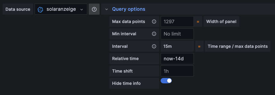

you should define the time in the panel itself using the query options, so that the Dashboard time setting will be “ignored” - in the example i am showing the last 14 days
