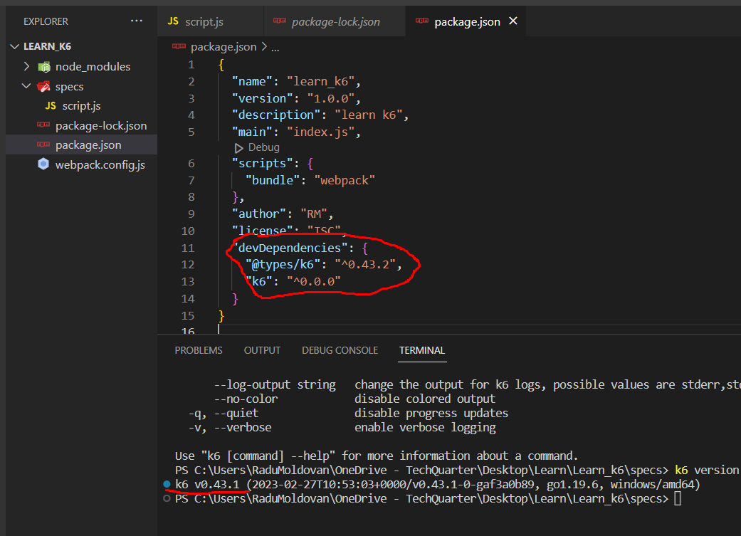

My O.S is Windows 10, k6 is at version v0.43.1

Thank you, with this command “set “K6_BROWSER_ENABLED=true” && k6 run script.js”, I can run, but just in the command prompt.
i want to run in vs code terminal-powershell, must be possible that…
That’s because the terminal in your VSCode is Windows PowerShell. In that case this should work:
PS C:\k6> $env:K6_BROWSER_ENABLED=true ; k6 run script.js
in this case, i receive the same error like first.
Have you tried wrapping true in '' such as:
PS C:\k6> $env:K6_BROWSER_ENABLED='true' ; k6 run script.js
