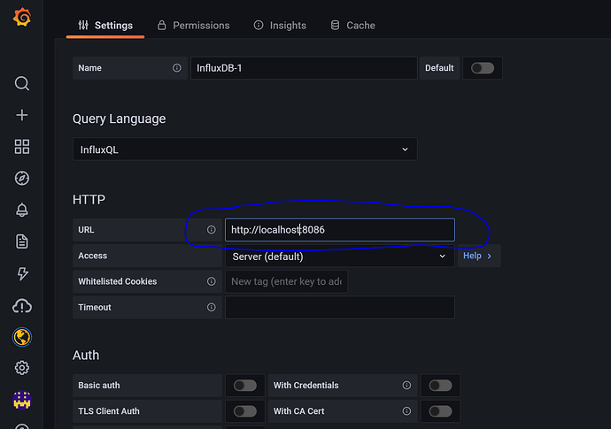

Bad Gateway Errors when connecting Data Sources, e.g. InfluxDB
CMD screenshot of me accessing influxdb using CLI interface in the Windows Command Line Prompt
access_influxdb_using_cli
Are you able to access the database from a command line running inside the grafana container? I don’t use docker with grafana but I do know that it is necessary to allow the container access to localhost for that to work. Have you tried using the ip address of the machine rather than localhost? Also check that works from the command line in case influx is only accessible via localhost.
[Edit] If you don’t need to enter a user/pwd to access the db in the command line they you should not have basic auth enabled or provide a user/pwd

http://localhost:8086 works - you just have to physically type it in the address, as what is shown is an example, and does not default to this

Hi Team,
I’m facing the same issue of bad gateway 502 and have tried all the above steps
can you please check? I will paste the snapshot of my grafana configuration here
