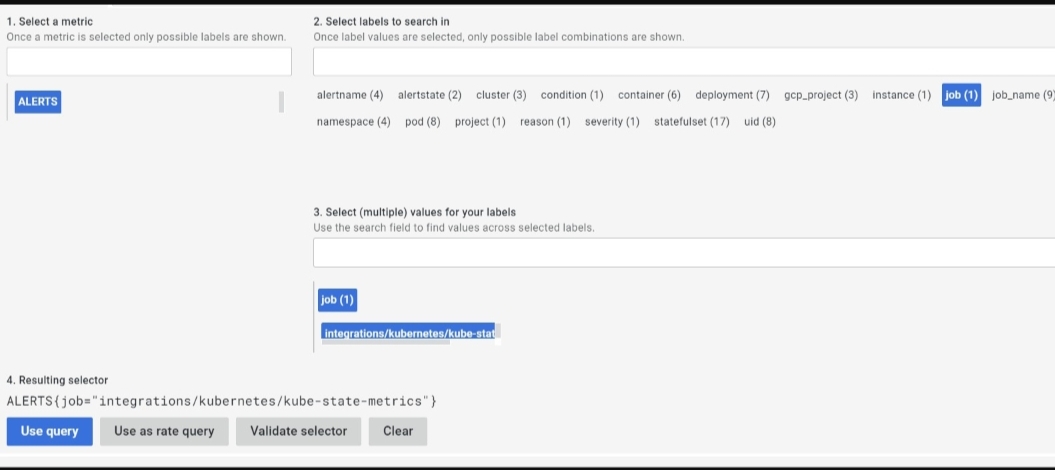

Hi @Melody ,
I appreciate the response, we are using Grafana-agent to send themetrics to the Grafana-cloud (Version 9.2.0).
I have set up several scrap jobs that are currently in the firing state. But not all of the scrape jobs appear in the ALERTS stats.
Here is a picture for your reference.
But the ALERTS metrics label only displays only kube-state-metrics job.
This is the configmap for the grafana-agent that we are utilising.

Hi @Melody ,
Identified the issue.
Only “Mimir or Loki alert” is supported by the ALERTS metric; “Grafana Managed alert” is not supported.
Is it possible to extend Grafana Managed alert to include the ALERTS metric?
