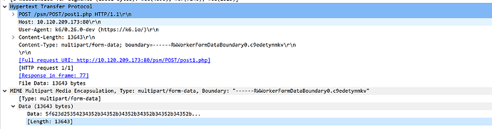

I used the example given in this Link Data Uploads to send multi part uploads but It is not working in k6. I tried same using Browser it works fine. Here is the screenshot of the Wireshark Capture I took for reference:
Non Working One Using K6 Tool:
Below is the K6 Java Script I have written for sending Traffic:

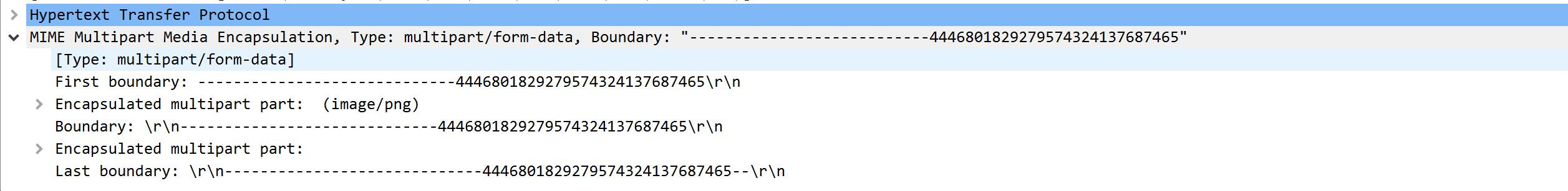

Attached is the Working PCAP Screenshot taken using Browser

I tested against a local httpbin instance, and the form was read correctly.
The sent request copied from Wireshark:

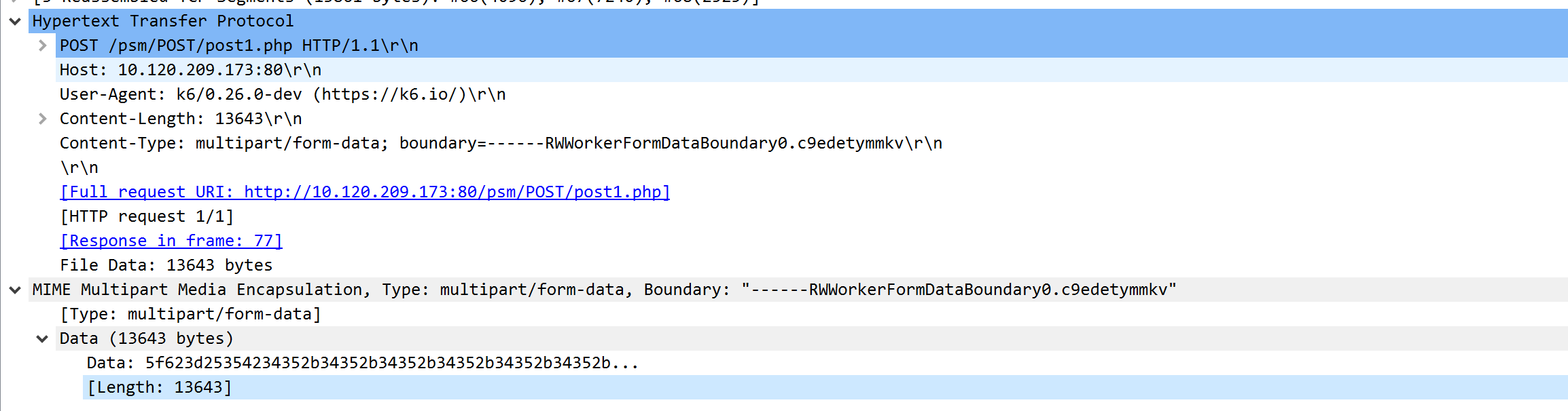

Below is the Wireshark Capture Screenshot I am seeing from Client Capture
Hi imiric,
The issue here is that packet sent out by k6 is not decodable by both wireshark and my server. If you see the attached screenshot of the Client Capture the MIME Header Data is not getting decoded correctly by wireshark like the way you have shown in your screenshot, which makes me to think client is not sending the POST Request Correctly. Any Idea why this is happening? FYI I am ignoring the Server Response as I see Client itself is not sending the Data Correctly. Also is this below line correct in the Script
import { FormData } from ‘./…/index.js’;
I basically downloaded the index.js from the link: https://jslib.k6.io/formdata/0.0.2/index.js and placed in local directory for reference in the script, I presume the reference made in the script is correct and also I think the index.js file I am using will work with my k6 version?

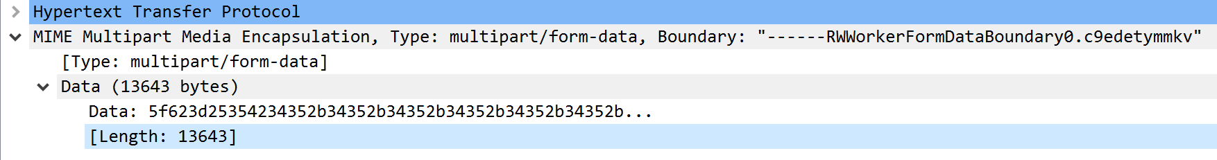

Here is the HTTP Packet Screenshot:
You are using a very old k6 version. Please upgrade to the latest v0.34.1 and try again.
I was able to reproduce your issue with v0.26.0, so upgrading should fix it.

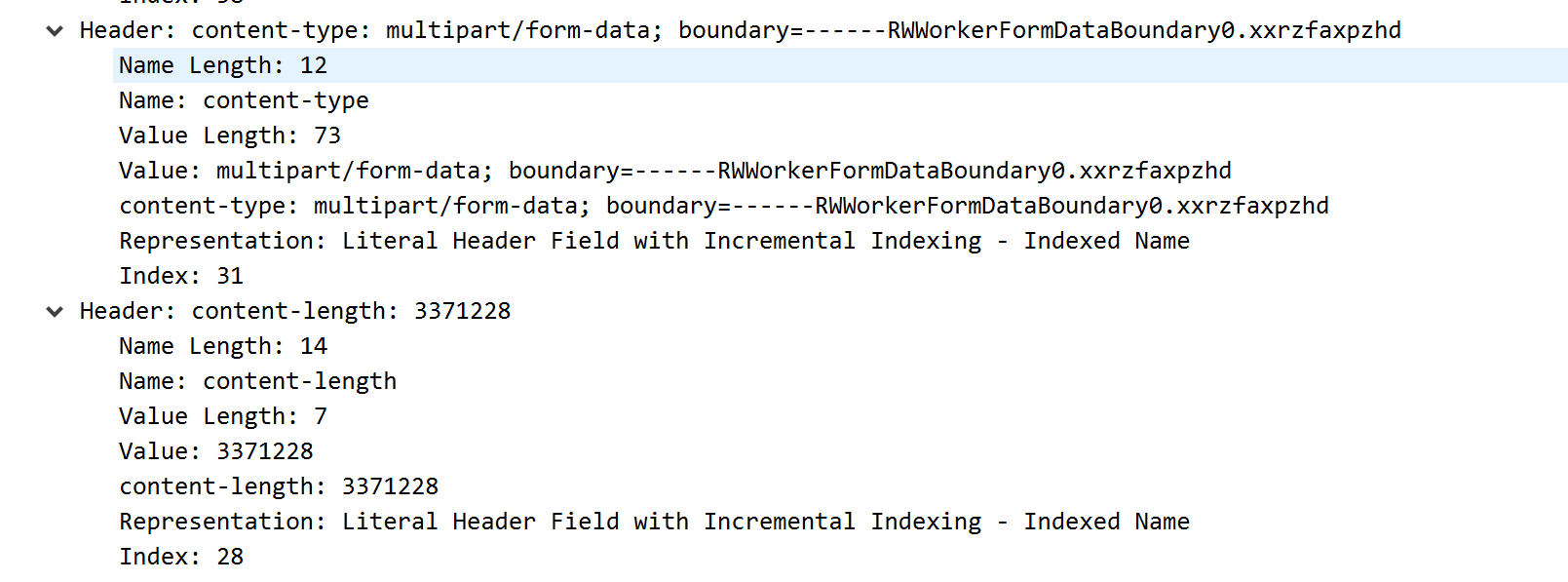

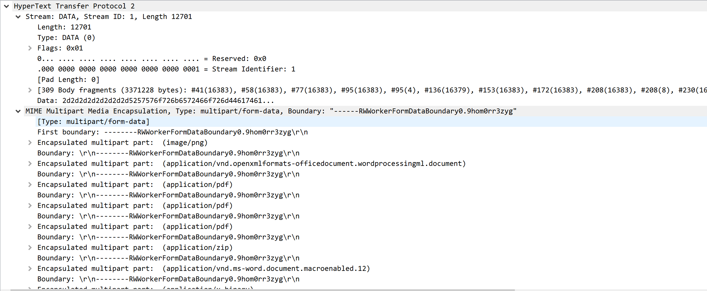

Can you let me know how the same Packets Looks like for HTTP2 Traffic as I see some Packets in Wireshark but I am not seeing multiparts in packet headers for HTTP2. If you can share some screenshots for HTTP2 Traffic just as the way you did for HTTP1.1 Traffic it would be really great.
Below is the screenshot for HTTP2 Post Traffic, I am not sure this is how multipart in HTTP2 should look like or is it a issue in Tool?
Thanks
Srikanth
Since HTTP/2 uses TLS by default and k6 doesn’t support h2c yet, and I don’t have TLS decryption setup in Wireshark, I can’t really capture the HTTP/2 payload to show you an example.
That said, the request body should be exactly the same regardless of the HTTP version used, k6 handles that transparently for you. Wireshark should decode it properly, handle multiplexing, etc. and show you the HTTP conversation. If you right click on a packet and select Follow > HTTP/2 stream it will show you the raw packets, which makes it easier to see how the multipart payload is structured.
Ok No Problem imiric, Finally I was able to Look at the multiparts in the Capture by Filtering Based on Stream ID, Also as you Suggested by Following HTTP/2 Streams. Below is the Screenshot. K6 Latest Version worked as expected with both HTTP1.1 and HTTP2
