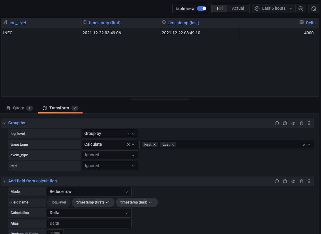

@abdel989 I’m not sure if you can do this in grafana, you could try the group by transformation if you have a consistent property in your logs that you can group by (is mid an event ID)? Then you might be able to use the difference calculation to find the difference between the first and last timestamp - you may have to play with formatting to get the result you want.
If you’re using logstash to ingest your logs there is a processor that you can use to add fields to your log events based on certain rules. Then you could visualize those fields in grafana. The elapsed filter calculates the time between two events.

maybe this
