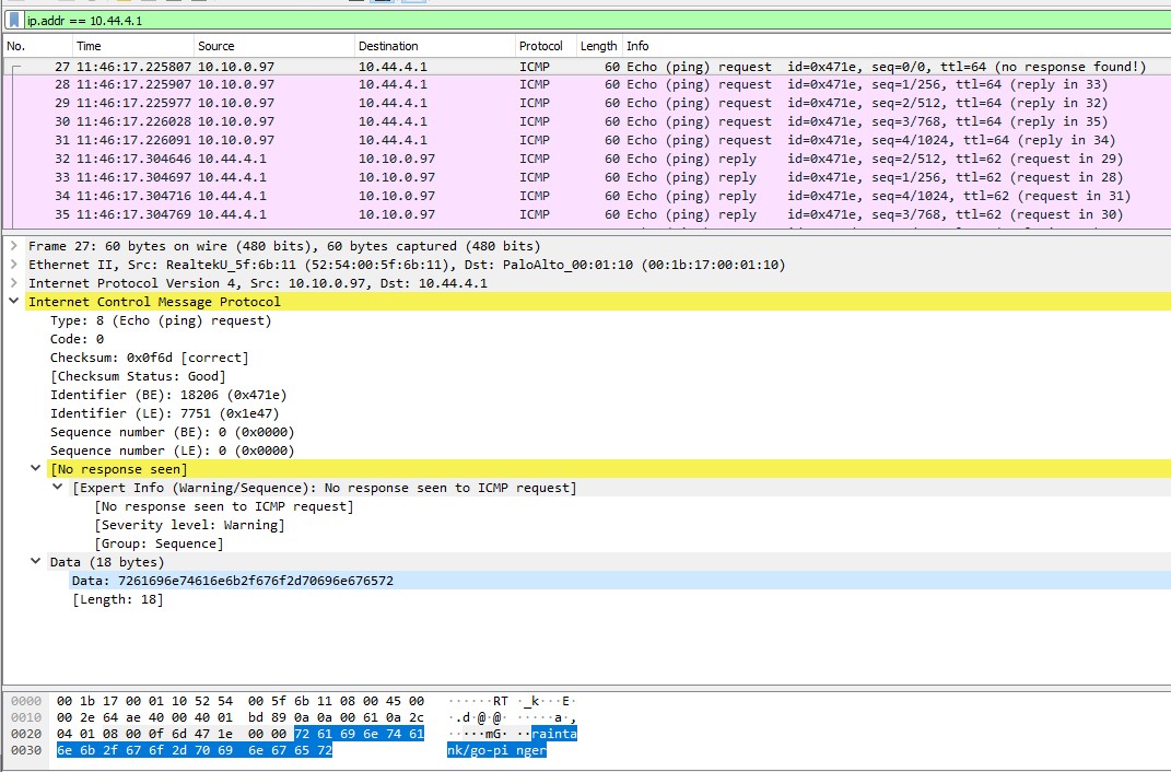

I notice WorldPing does 5x ICMP requests then wait for reply. Another tool we use does 1x ICMP request then wait for reply, 5x. We have a set of remote destinations that don’t like the 5x request and reports 1 out of five drop on most polling cyles.
- Can I adjust this functionality and go to request>reply, instead of 5x request burst?
- Should I push to investigate the ICMP drops from the remote devices? ICMP can be treated differently on devices than just UDP/TCP, I’m not sure I should push the issue.
- Is there anything to WP using 18 byte vs. some other size ICMP request size?
Thanks,
Dan
Raintank Wireshark
Other (PRTG) Wireshark
