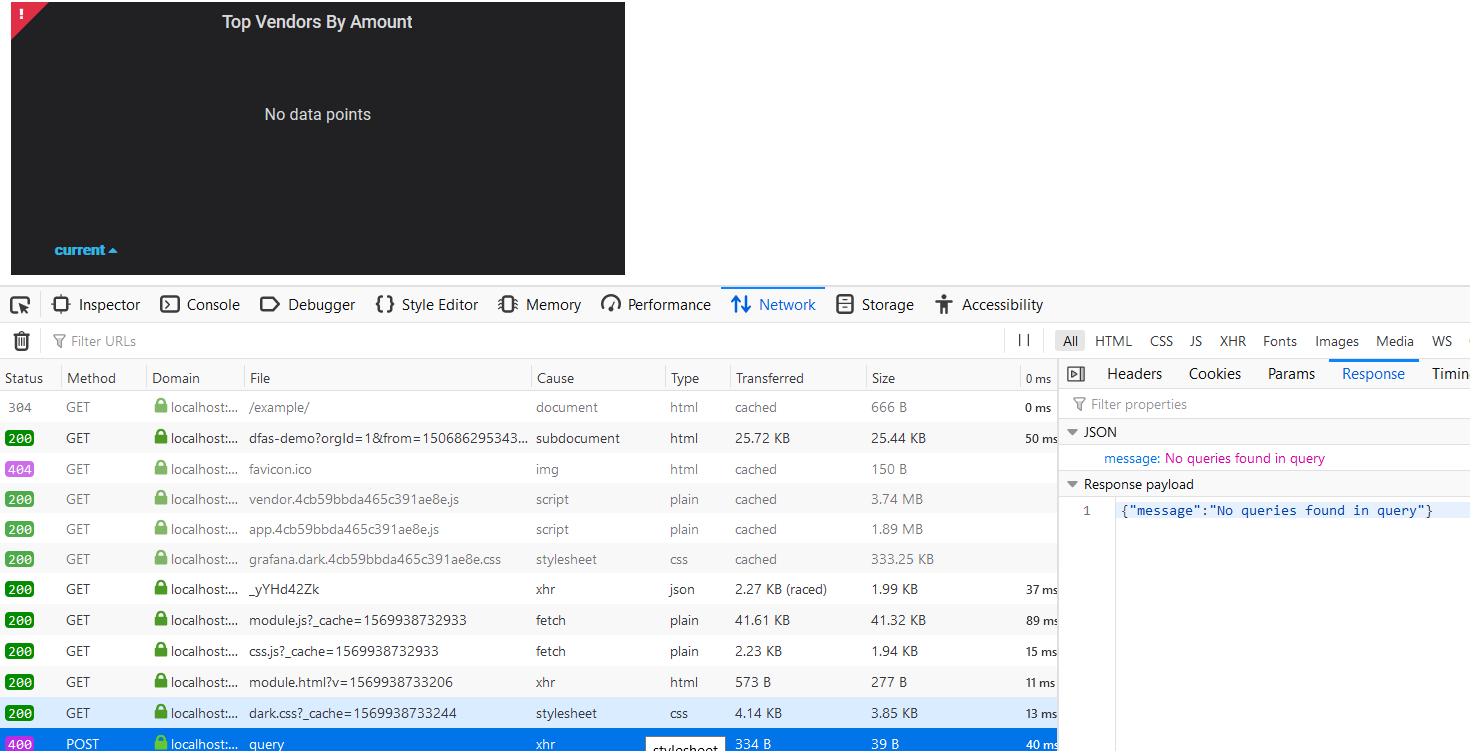

I am attempting to embed a grafana panel in an iframe on my website, but the POST request for the query never returns any data,
 ![problem](https://us1.discourse-cdn.com/grafana/original/2X/8/8bc52aeba6f854352a5805a93d062681388ff4c1.png)
and it tells me my request is bad with a 400 error. I have my request going through a NodeJs Express proxy listening on port 8000 that forwards it to my local Grafana server running on port 8080. The middleware the handles this is below,

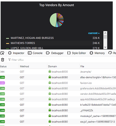

Still returning a 400 error with the query POST.
If this helps, this is how I am putting the panel in the iframe:
 <iframe src="http://localhost:8000/grafana/d-solo/_yYHd42Zk/dfas-demo?orgId=1&from=1506862953434&to=1569934953434&panelId=2" width="450" height="200" frameborder="0"></iframe>
Interestingly, if I change the host port from 8000 to 8080 (where Grafana is running), I get the data returned, even though it’s not going through the proxy and getting the API key attached to it,
 ![problem_2](https://us1.discourse-cdn.com/grafana/original/2X/5/5f749354ccc1ec7ee9b0461b78b592bed2a362aa.png)
I assume this is because I am logged on the current session. It’s still strange this gives me data, no?
