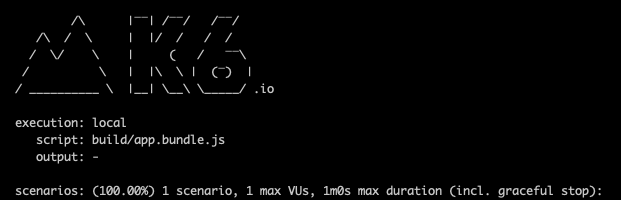

I tried to use --vus flag with the following command
k6 run --vus=10 build/app.bundle.js
but the value doesn’t change.
The test was executed on k6 v0.32.0
How do I set the vus parameter properly in the CLI ?
