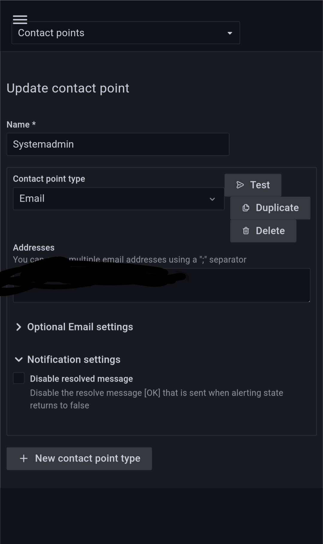

In Version 8.4.4 I can’t see this option:
I am new to Grafana, but I think you should create a new notification policy and override general timings :slight_smile:
I think this is the real solution. This did work for me.
this depends on if you are using legacy alert or the new unified alerting:
