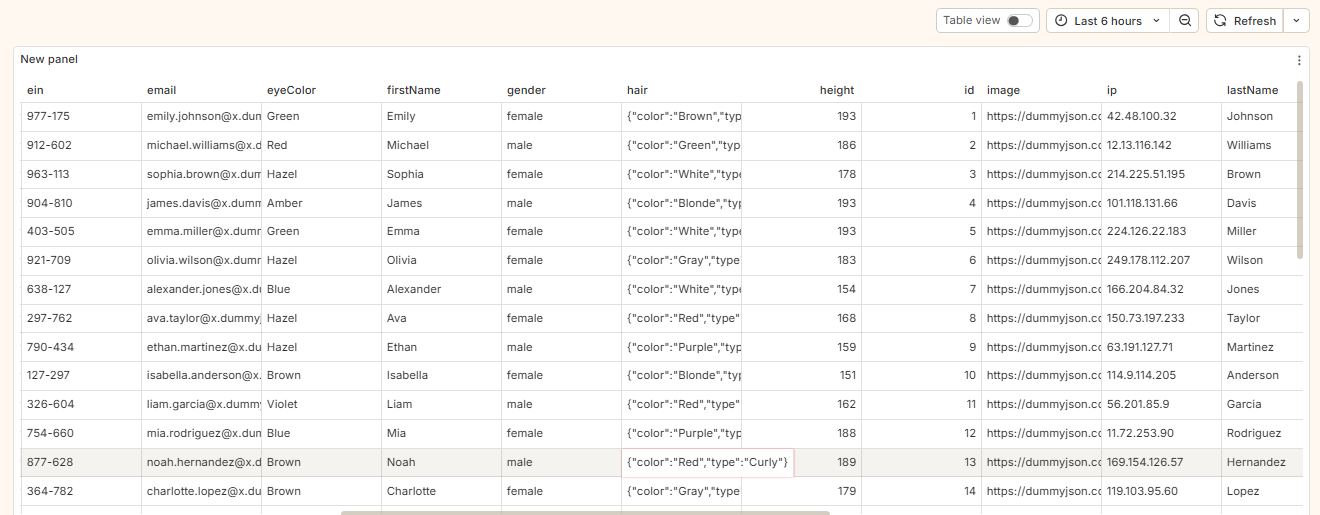

you can consider this solution to resolve you issue
Step 1 Create a Rest API or Pick a dummy user data from
https://dummyjson.com/users
Step 2 Integrate the infinity data source in grafana
Step 3 Setup the setting in Dashboard
Final Output :
