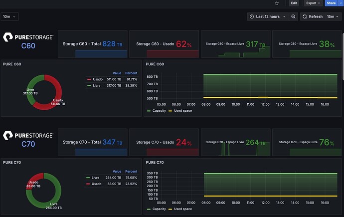

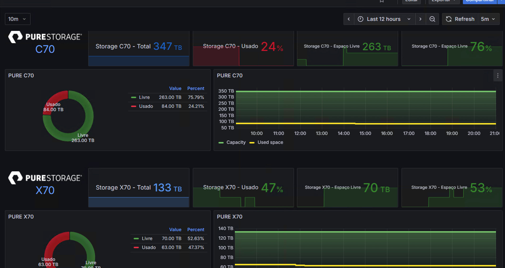

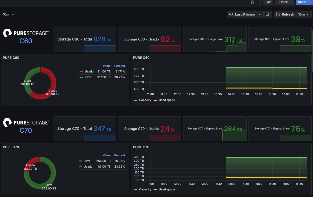

Guys, can you help me with a question:
I configured the plugin in my Grafana v12.0.2 (5bda17e7c1), the plugin is working but there are 2 things that are bothering me:
1 - When loading a complete dashboard, it always fails to display some panel. I always have to keep clicking refresh to load the rest.
2 - I’m using America/Sao_Paulo Brazil UTC-03:00 and the times are correct. However, any date/time range I select in Grafana, the panels don’t show the entire range. Example:
  • If I select the last 6 hours, the graph only shows the last 3 hours.
  • If I select the last 12 hours, the graph only shows the last 9 hours.
It seems to always cut off the first 3 hours.
@maxmarkusprogram can you help me with this?
I’m using Rocky Linux 8.10.
See the images below.

Guys, I found the problem :slight_smile:
Problem Summary
  • The plugin converted the time range twice:
  1. The range coming from Grafana was forced to UTC and,
  2. On the backend, the API converted it again to a hard-coded time zone (Europe/Berlin / Avrupa/Istanbul).
  • This double offset caused a ~3 hour cutoff at the beginning or end of the graphs when the environment was in America/Sao_Paulo (UTC-3).
  • The parser also converted times to time.Local, which could apply another offset depending on the host.
