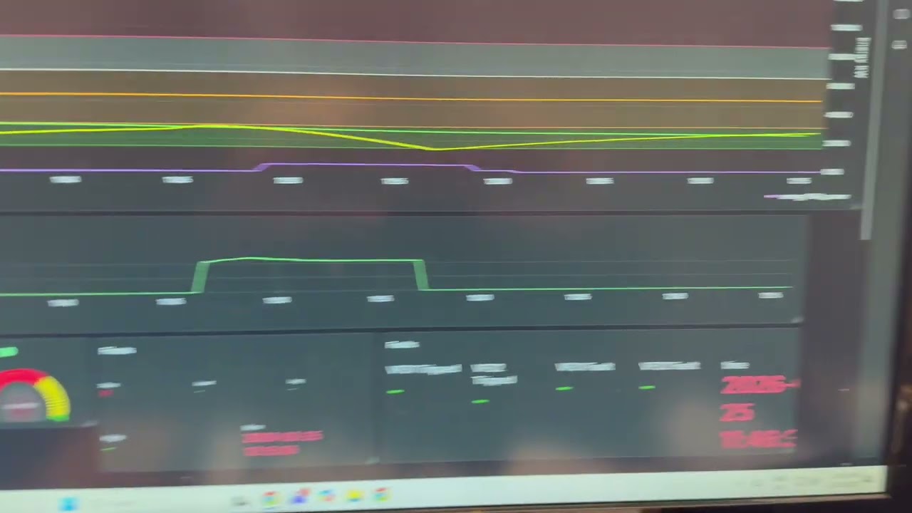

I have a series of gauges and stat panels in the bottom of my dashboard that should be displaying the “Last” values of time series data. This data is being sent to a cloud based influx db, and also I am sending it out to an MQTT broker every 10-20 seconds. I have tried display the data from an influx query, and now I tried to alternatively get the data directly from the MQTT broker.
In both data source setups, the data being displayed is not consistent, it randomly picks a different time period to query, I get ‘no data’ displays.
I have uploaded a video of what it looks like, see link below. The time was 12:15. You’ll see the mag flow (bottom left with a reading of 16.5 cu/hr, the ‘south flow’ gauge right next to it is the same data (showing zero), and the time series shows it to actually be zero, and the two bottom right panels are showing data from the influx time series, but the one on the right is using the wrong time at 11:46, then updates to the correct time. These panels seem to alternate picking up the incorrect time every few seconds.
Can anyone suggest the issue???
