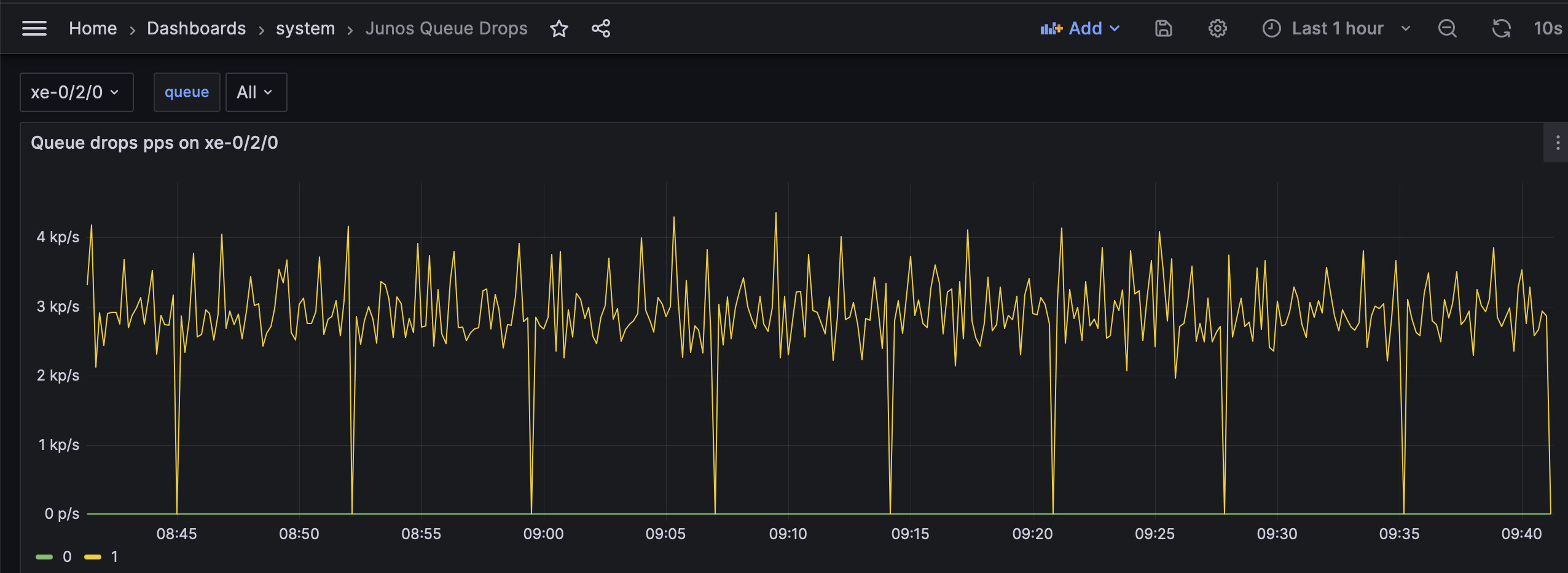

Hello All, I am working with Juniper EX switches to stream interface queue performance. I want to be able to see more fidelity on the performance. I am running grafana 10.2.2 and telegraf 1.34.4 with GNMI plugin. One thing I have noticed is every ~5 minutes I will get drops in my graph. The data from Influx 1.8 seems to be there and accurate however Grafana shows these dips. I am using the following query based on 10 second sampling rate configured in Telegraf.
Grafana query.
SELECT
NON_NEGATIVE_DERIVATIVE(LAST(“interface/state/counters/out_queue/tail_drop_pkts”), 10s) AS “tail_drop_pkts_rate”
FROM
“interface-queue”
WHERE
$timeFilter
AND “name” =~ /^$interface$/
GROUP BY
time(10s),
“name”,
“queue_number” FILL(linear)
Influx query:
SELECT “interface/state/counters/out_queue/tail_drop_pkts” FROM “interface-queue” WHERE time > now() - 15m AND “name” = ‘xe-0/2/0’ AND “queue_number” = ‘1’ LIMIT 30

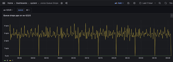

Try this…
SELECT
NON_NEGATIVE_DERIVATIVE(MAX("interface/state/counters/out_queue/tail_drop_pkts"), 10s) AS "tail_drop_pkts_rate"
FROM "interface-queue"
WHERE $timeFilter
AND "name" =~ /^$interface$/
GROUP BY time(10s), "name", "queue_number"
FILL(previous)
That seems to make it look worse. I don’t think it is the data. What else should I look at?
So why do you believe something is wrong when you have this data?
Maybe you have something that cleans the queue every 5 minutes, so then you will have, of course, lower packet drop at that time.
Routers and switches don’t behave that way. They constantly are servicing the queue in microseconds. I feel like its a timing problem with data timestamps and grafana showing the drop in traffic.
