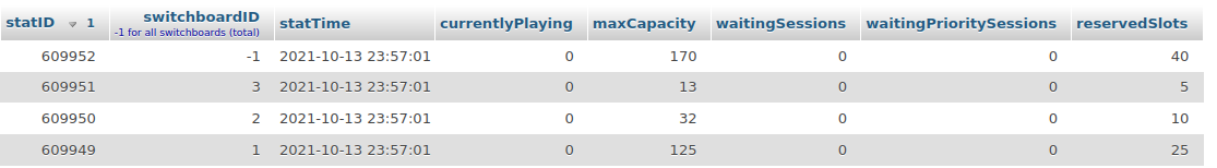

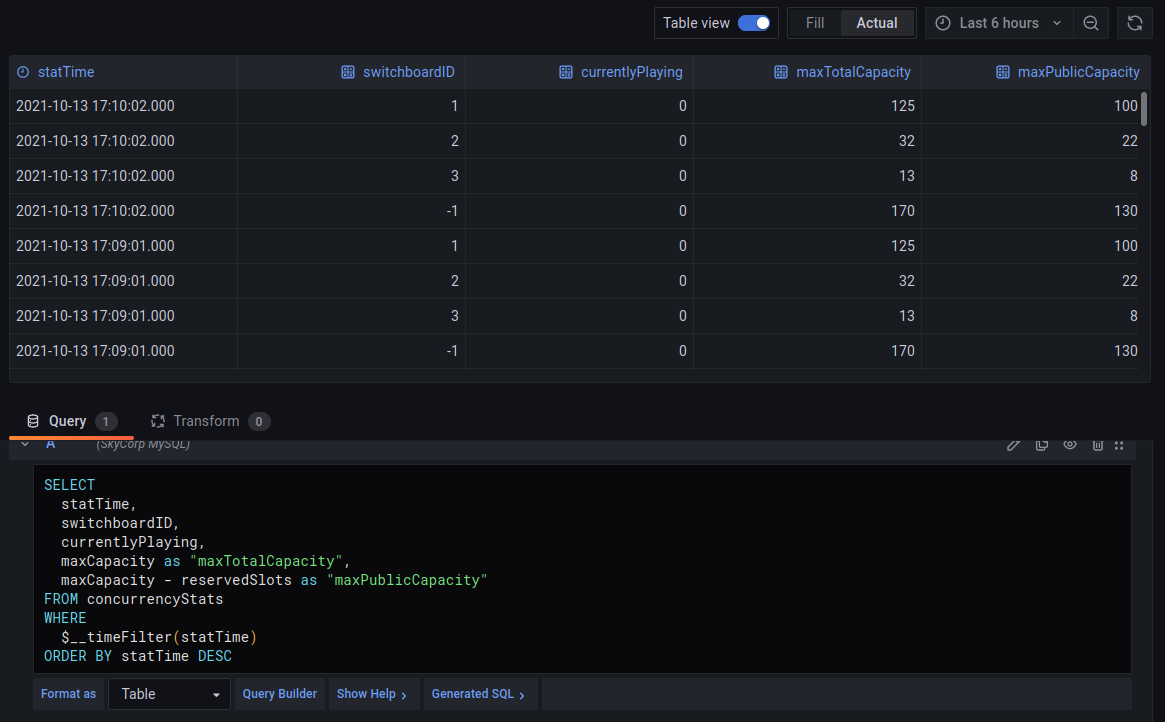

Database: In my table, each server is assigned a 'switchboardID' (1, 2, 3 (or -1 for a system-wide aggregation)). Each minute, a stat is recorded for each server to a table ('concurrencyStats')
![image](https://user-images.githubusercontent.com/22365940/137229170-86b92a64-d05a-4125-a0c9-ddc95104bf32.png)
I write my query and am able to get my data OK:
![image](https://user-images.githubusercontent.com/22365940/137229522-11d4d928-e6bd-40f4-98c9-ee484bf04827.png)

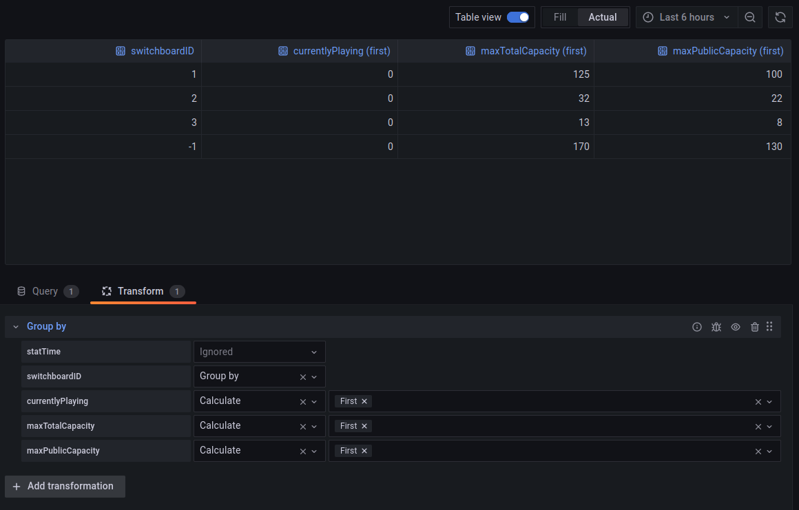

Now I discard old data by using a Group By, selecting only the latest value for each switchboardID:
![image](https://user-images.githubusercontent.com/22365940/137229628-827144ba-6f8c-4282-95b1-b52383125fa8.png)
Now I have just the most recent data, with one gauge per row.

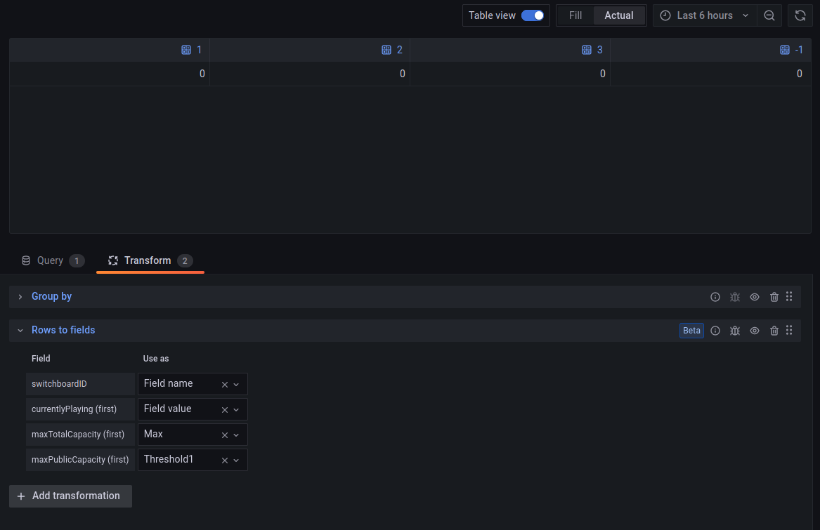

I have read that by using fields, I can configure the display of each gauge. This would allow me to have data-driven Max and Threshold configs. So I add a Rows to Fields:
![image](https://user-images.githubusercontent.com/22365940/137230037-9ebe0ec7-08dd-4f77-9f89-8b92404b7d1b.png)
This does seem to work, except I don't see any configuration values applied. IE, I would expect, [as in the docs](https://grafana.com/docs/grafana/latest/panels/transformations/rows-to-fields/), for the field name to be something like `1 (config: max=125, threshold1=100)` instead of just `1`. Maybe it is happening silently though, so I check in gauge...

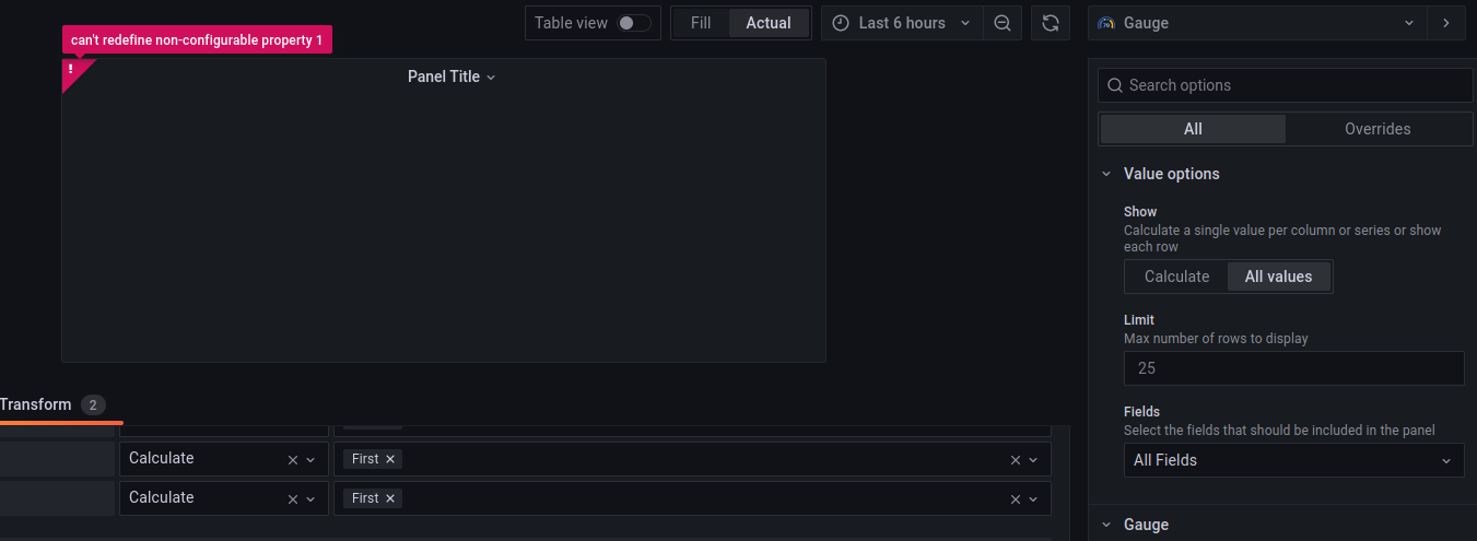

On gauge view, I get an error 'Can't redefine non-configurable property 1', though table view looks like it should work (just most likely without configuration settings attached)
![image](https://user-images.githubusercontent.com/22365940/137231469-18271f85-7b62-42ba-bd15-572bd0eb41e4.png)
So, I am not sure if I have encountered a bug, or user error. Can you please advise? Thank you!

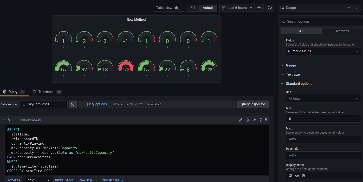

**Workaround method attempted but failed: Rows**
Sidenote, I have also tried to set up gauges by using rows instead of fields. This lets me see four gauges, but I haven not been able to customize each. Using the `${__cell_0}` syntax requires fields to be set to Numberic Fields, and then I end up with way too many gauges (one gauge per cell in the table):
![image](https://user-images.githubusercontent.com/22365940/137232984-4dc5066a-ec27-4b62-a0d8-4dcf1541bcae.png)

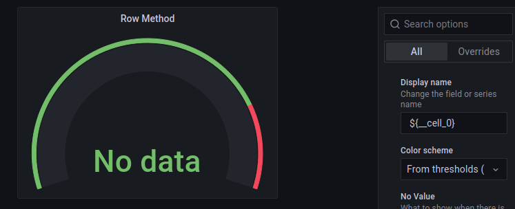

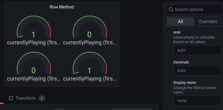

Setting the field to just currentlyPlaying displays the correct number of gauges, but then I can't customize them with `${__cell_0}` (doing so returns 'no data' on the gauge):
![image](https://user-images.githubusercontent.com/22365940/137233443-d18565eb-3559-4d02-aae3-17a0cbf8dfcd.png)
![image](https://user-images.githubusercontent.com/22365940/137233484-7f1a56e4-2c90-4548-8d8d-9e873b3e537a.png)
