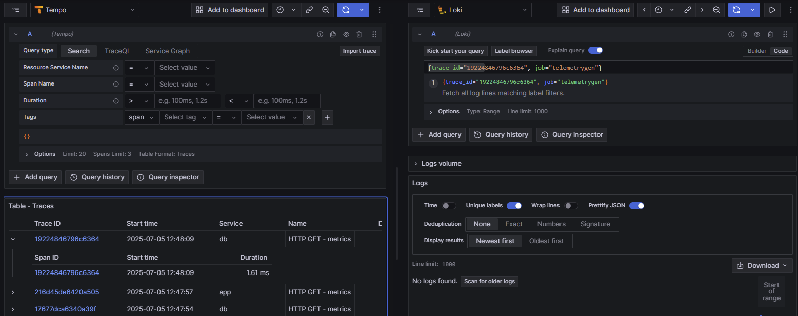

    Using auto instrumentation using Beyla to send metrics and traces to prometheous and Tempo. And then correlating the traces to logs sent by prom trail to Loki.
    The logs are for legacy applications which does not have trace Id and such instrumentation built into it. Therefore we are choosing to use auto instrument, this way we will need less code correction or addition.
    if you see in the image i do get traces with id’s but as no logs contain that trace id so they are not found as well.
    These trace id’s are generated by Beyla. Is there anyway to inject them to logs as well?

Beyla cannot inject trace IDs into logs of your app by itself.
you can try this way to fix your issue :-
  1. Use Grafana Alloy instead of Promtail
  2. Enable trace-to-log enrichment in Alloy config
  3. Send logs to Loki after enrichment
Could you provide any documentation about trace-to-log enrichment in the Alloy, please?
