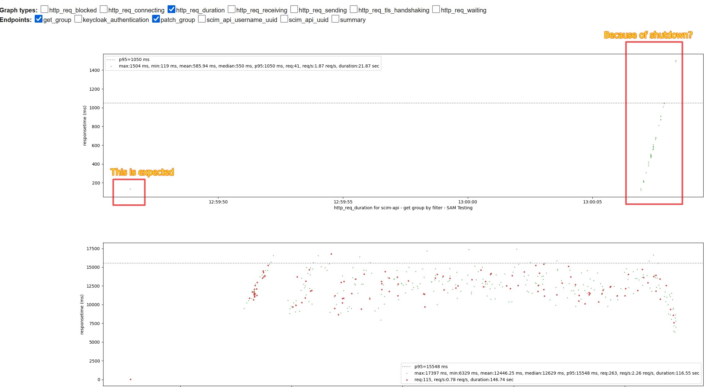

But why do they show up at the end?

That graph shows 1 and then like ~20s later a bunch more requests, is this correct? I can see how depending on what and how you make the requests or even what output you are using, this might act differently.
Also, the time of the event is when the sample is emitted (so the end of the request). With this particular response times this might not change a lot more when they were actually started. But looking at it there are good chances they were started exactly at the same time.
This might mean that the first request is not the same as the rest and instead is something done in setup
